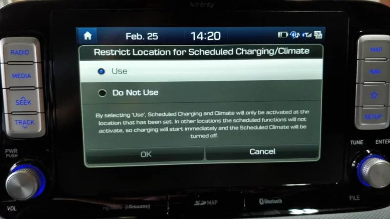

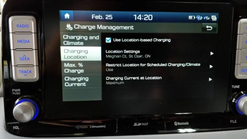

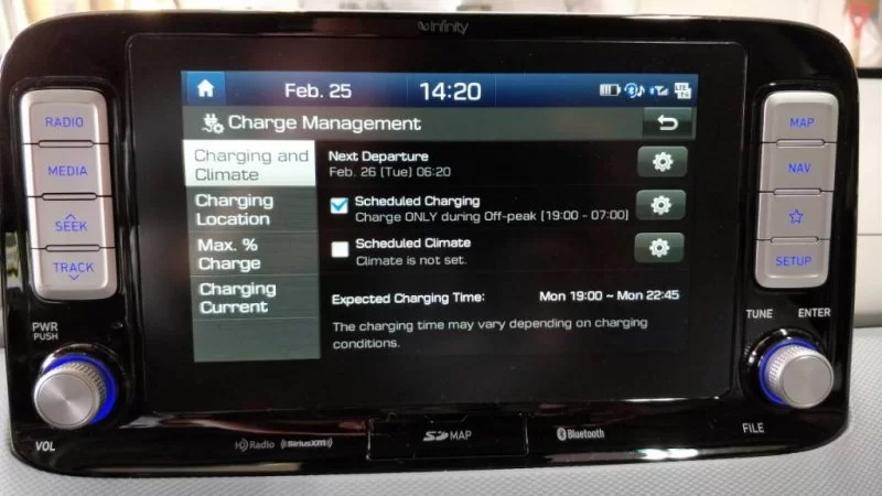

Alrighty, I'm hoping this will help ya! I went out and looked through my settings and took a few pics and hopefully it's a simple fix.
This is what I have setup with mine so it will start charging no sooner than 7pm. I think the step you might be missing is the next one.
When you go to the location based charging tab, you have to set an address as home, and then under the Restrict setting turn Use on. What this will do is force the car to respect your Time of Use settings at your home, and not care anywhere else such as a DC fast charger or a mall parking lot charger in the middle of the day.
That's the only thing I can think of that wouldn't be working for you, that Restrict setting is turned off, or you haven't entered an address in the location setting.
Check it out and let me know what you find out!

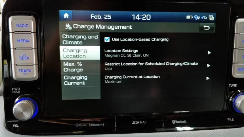

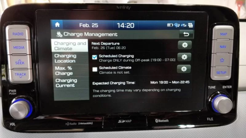

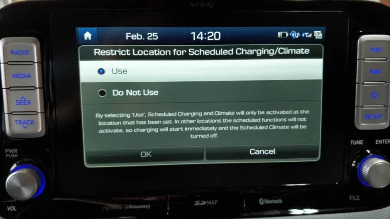

First of all, wow and thanks. Your assistance here is really above and beyond the call of duty. But, alas, I've done everything you've indicated. I can't really check again until next time I drain some power off and plug back in.
