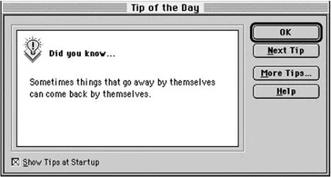

Yes, in the wisdom of Microsoft Word (even before the prescient Clippy):
