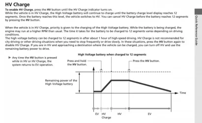

Understanding the features available on a vehicle certainly has benefits. HV+, (aka: HV Charge) will charge the battery up to approximately 60%, or 12 bars out of 20 on the battery status display.
Several owners have reported that HV+ charges with remarkable efficiency when it is used as recommended in the owners manual. Even with higher gas prices some owners may find the difference in the cost of a gallon of gas or 14kWh’s of electricity to be insignificant. I was recently in Connecticut where regular gas was $3.00/gallon and the average cost of electricity is $.22/kWh, or $3.08 for a full charge.
Another well documented practice that many owners follow is to engage HV at the start of a trip where there may be demanding driving conditions or the distance will exceed the EV range. Doing that preserves the HV battery SOC for use at another time.

HV charge is in the manual as in "what it does," but not necessarily "how to best use it."
Here’s the guidance on HV Charge from the manual. Pretty straightforward on when to use it or not use it DDA783FA-1908-4466-8ECD-D645C883AFE9.webp
