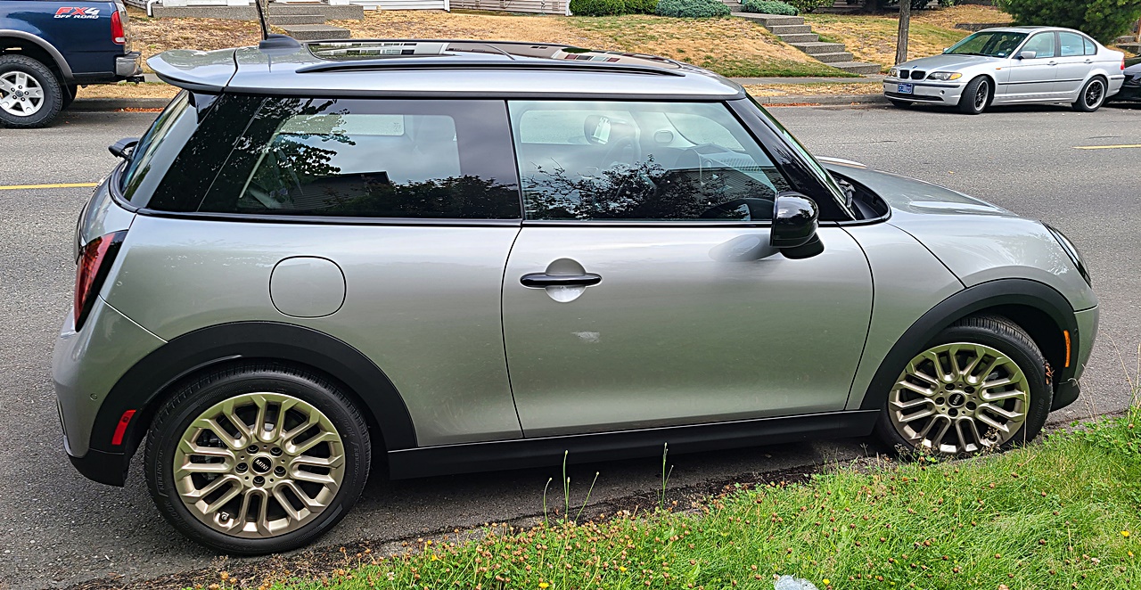

Since April I have been having the problem (second time) where the car says the charge socket flap door is open when it isn't. Have reported this a few times. Have not had it in for repair again yet.
As of two weeks ago, the door started "sticking" and not opening. I was able to get it open with a gently pry and a little percussion (instead of pushing it in, I had to lightly bang it with my fist). This was working reliably when it stuck (which was most of the time).
As of last night, this is no longer working. I could NOT get it open to charge Sparky. SOC is about 30% and the dealer is about 20 miles away. BUT we are going to be away until late next week so it will sit until then. I don't know if it will have enough juice to get to the dealer. If the range says I'll make it, should I risk it? Or should I request a flatbed tow so there is no issue?
Of course, if I can get it open before then I can charge it. Any non-destructive tips for opening the stuck flap???
Thanks folks.
2 yrs, 9 mo. 32,000 miles. Warranty in effect.

If what teslarati97 suggests doesn't work, I wouldn't sweat it. Sparky won't lose any significant charge sitting for just a week, and 30% SOC is plenty to travel 20 miles (unless perhaps it's up a mountain in a snowstorm).

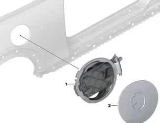

Also forgot to add, you could try to retract the extending spring loaded plastic propeller locking mechanism? Might have to go at it from an angle like 1 o'clock facing the charger flap.
We had to have the charger door "replaced" under warranty. They kept the car for a week and had to swap parts at the Mini Service Dept. It would either lock closed or lock open. Something internal to the spring lock posted by teslarati.
dropped Sparky off at the dealer. Had 30% SOC still when I left. Drove the 21 miles in Green+ at 60 MPH. Arrived with 15% SOC.

I suspect it's a holdover from the ICE F56, because locking the EV charge port hatch is silly.
Its a different port and steel pressing for. Fuel door is different on F56
The assembly was replaced on my car under warranty and is under 200$
The service center sent me an update today. The locking/latching pin is broken, apparently both physically and electrically. They have to replace the entire assembly (again as that was the same repair for the false charge flap open message).
