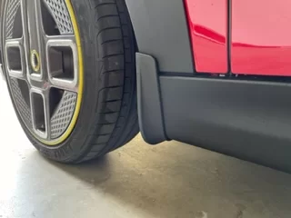

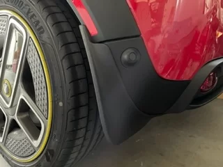

The part number for the rear Mud Flaps is : 82-16-2-338-566
You can order these from most BMW and Mini dealerships. Copy and paste this part number when you google it, and it will provide you a list of places that sells them.
You can also order them directly from MiniUSA.com web site
Word of caution, installing them (DIY) is a pain.
The metal clips that holds down the flaps are pain to insert as well as the gap between the rear tire and wheel well is narrow.
If you remove your rear tires, it may be easier to install but the metal clips is still a Pain to insert. Get yourself the proper vise to push in the clips.
Hope this helps.
What is the proper vise? I gave each clip a twist with my screwdriver to make them just a little bigger, started with a corner, and bitched the whole way. On one the clip fell into the front flap. Of course it was the third clip, and i stuck the tape. so inside the flap it will stay. Also each clip has two little ears on one side. I put them on the flap side so they would dig into the flap.
Yes, using a screwdriver to widen the gap on the clips helped but it was still a '*****' to insert it.
The front flaps went in slightly easier as I turned my wheels to one side and gave me more room to insert the vise grip. With the vise grip, I was able to compress and insert the clips but it was still a PITA.
Getting the rear was a piece of work as I was not in the mood to remove the rear tires, resulting more sore fingers getting the clips engaged. If I had removed the rear tires, it may have been easier as I would have been able to use the same vise grip to compress the clips in place.
I jacked up the car so I got a little more room for the rears. How did you hold them with the vice grip?
The vice grip held between the top edge of the clip and the rubber edge of the flaps. I did tape up the jaw of the grip to prevent/minimize marking of the rubber edge of the flaps.
This clip design is a PITA and it is typical for flap installs on BMWs.
Sure brought back memories (NOT) when I installed the flaps on my X5 and 3 series years ago.

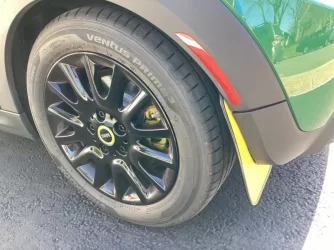

My custom flaps bc I’m going tor yellow as much I can add to my SE
