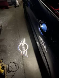

Fun fact: OE accessory MINI mirror caps from the parts department aren’t drilled for the logo puddle light.
Last night and early this morning, I couldn’t see the projected logo, and for the life of me I couldn’t figure out how to activate it. It was only after I coded the mirrors to fold in with the key that I noticed there was nowhere for the light to exit. I guess another “to-do” item now, remove the driver’s side Night Jack Mirror Cap, and use the original black one as a template to locate a hole, then drill and enlarge it with a file. Grrr.
Hopefully there's a knockout. And since it's driver side, the hole must need to exist on the right-hand mirror cap for left-side driving countries right? What if there's a projector on both sides, maybe just need an extra hole.
Popped off the Night Jack mirror cap using a plastic trim spudger, and of course it sprang off the housing, I juggled it a couple of times, and of course it landed butter side down on the dirty concrete floor. Only a couple of tiny nicks that I’ll be able to buff out when I get around to polishing out the DISO (dealer-installed swirl option) and ceramic coating the car.
The Night Jack is a skin over a regular mirror cap shell — I compared it to the original black cap, it’s twice as thick — and sure enough, the hole for the projector is there on the inside layer. I used a sharp tool to puncture the thick outer skin in the centre of the oval-shaped hole, then used a small bit to drill a pilot hole before boring it out with a stepped bit, and finally shaping and finishing with a round file. Tomorrow I’ll check the passenger side for a projector. ;)

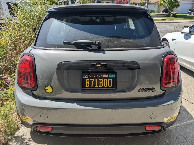

I bought some yellow POR-15 caliper paint for mine, but haven't gotten around to it, yet. I painted my license plate numbers just to see if it matches: it doesn't. Our energetic yellow is paler. For my calipers, it's fine by me.

I need to see the vht or g2 to say. The por-15 is darker (more golden) than energetic yellow.
(License plate numbers)
Edit: just noticed the buttons to post a message are pretty close to energetic yellow!
Ahh got it thanks for posting a picture.. yeah that looks much different than the swatch online. Super helpful, thank you! Yes the site buttons do look pretty close eh? ha!
