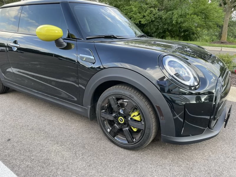

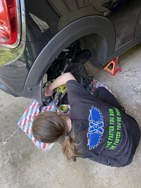

Caliper painting update: I had G2 mix a custom body color paint that was very close to Energetic Yellow on the Pantone scale, bought a proper floor jack and some stands, and attempted this as a DIY project over the long weekend. With some help from my daughter, I think it turned out OK. The color is a little more muted than I expected, but there's not much I can do about it now. Learned a lot (and saved a lot of $$)!
View attachment 18170 View attachment 18172
Your Mini SE and mine look very similar, except I don't have the yellow mirrors, however I have the same rims... I too bought the custom G2 paint, good to know it's very close to the actual energetic colors... it's been too hot here lately for me to paint the calipers but I'm hoping with the cooler weather coming I can knock this project out soon!

Thankfully no major issues or learned lessons to share, it was pretty straightforward. Even though the G2 system is brush on and not spray, I'd still recommend covering things with a garbage bag just in case. A small hole cut in the bag and then stretched over the caliper and taped to hold up worked well.

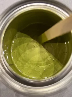

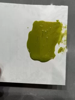

@LittleWoods - was your G2 custom paint (C4N) green? I'm so frustrated, I got my car up on all 4 jacks, wheels off, calipers cleaned, everything taped off and open the paint of can to find it an odd green color, nothing that even resembles a hint of yellow. I dumped the hardner in and let it sit for 5m thinking maybe as it cures a bit it'll change a little... nope still green.
I was too nervous to put it on my car so I sealed the can back up, put the car back together and ended the day completely frustrated. I'm not sure if G2 will give me my money back because technically the paint is 'used' even though I didn't use it. I'm going to call them on Monday and see how far I can get.
I noticed on their site they had this Mini yellow: https://www.g2usa.com/product/CBCP-902.html that seems closer but I don't know could end up also looking funky... maybe I just go with black and play it safe all around?
But I think we can all agree that G2's version of energetic yellow (C4N) is not at all energetic or yellow! UGGH!!!
MINI has different yellows, which I learned when I got Countryman yellow wheel caps. They don't look anything like the SE's Energetic Yellow, so I ended up replacing them with actual SE wheel caps.
Sure I understand there are differences.. my frustration is that they say if provided the right manufacturer's code they can custom match any color... but if I google C4N what comes up isn't even close to that weird green color they sent me.

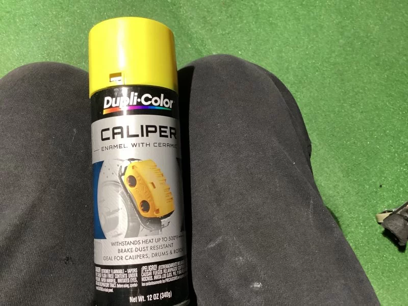

I use this yellow on my calipers and bc is behind rims lighter yellow shows much better than factory spraying in to a tuna can use soft small brush good quality I did 3 coats as a car was up of the ground 4 wheels just work around and be above 65” temperature and don’t drive at least over night. I did this with 70 miles on odometer just wipe a dust as preparation for painting and with Victory spokes I don’t see my beautiful job I did.
