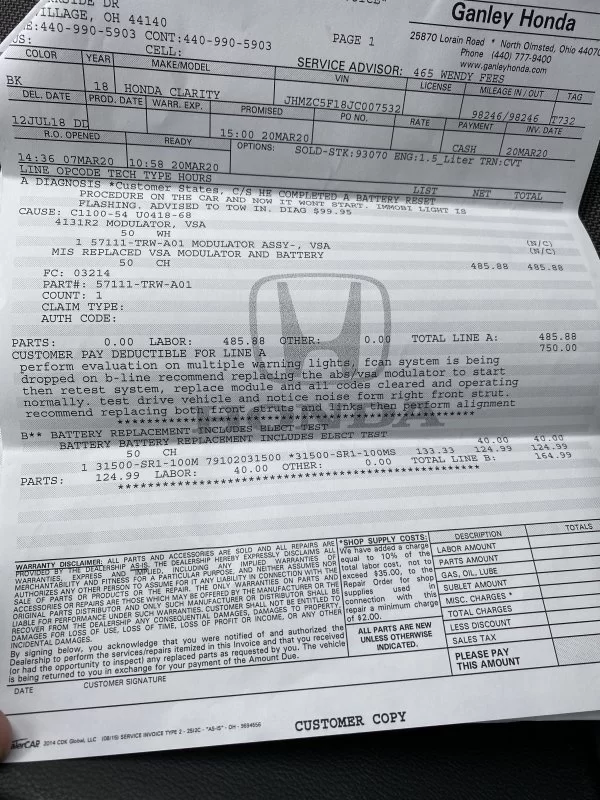

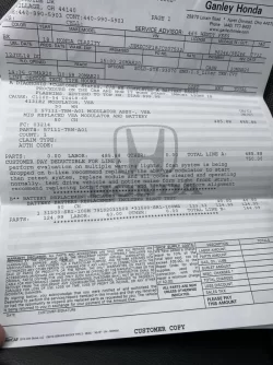

Thanks for the update! Glad it worked out better than quoted. So based on your invoice, was it just the ABS Control module (the actual hydraulic multi valve) or was it the ABS Computer? Just curious what the final out the door assessment was. Also, did they install (maybe didn't document, who knows) the updated -A01. Sorry, being a pilot I am used to very detailed maintenance log entries and tracking of part revision numbers. Just my curiosity. Glad they fixed it for a fair price (I doubt you would have beat that anywhere)!

What is A01?

Sorry, in my earlier post I put the part numbers as found on the web (may not be right - again just a guess from your posts). "57111-TRW-A00 is the ABS control module, however there is a note it has been replaced by A01 on the parts list. This is possibly due to a problem with the original A00. Might be worth the questions, and if so - a call to Honda as one of their prototype owners! All they can do is say no."
So that was my question - wondering if they installed the updated part. In my industry (not unique, we just watch it closely) dash number changes are likely due to design flaws discovered in the field. Your ABS failure at that age and mileage was pretty "young" so again, just curious. Let's me know if I have the same dash number to watch for it maybe failing early. (I'd bore you with stories about elevator trim tabs locking up and loss of pitch control due to known "dash number" failures, but hey - pilot fun is just that, shear excitement at times...)

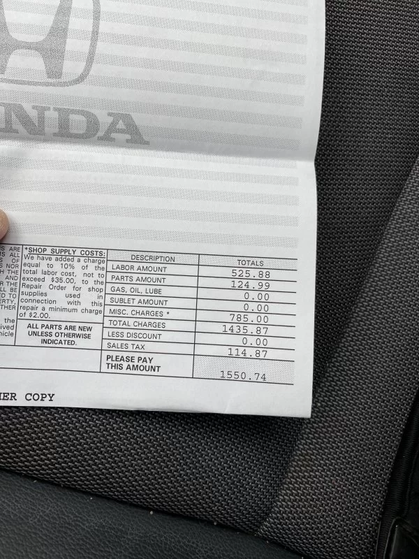

My bill. A-01 is listed.
