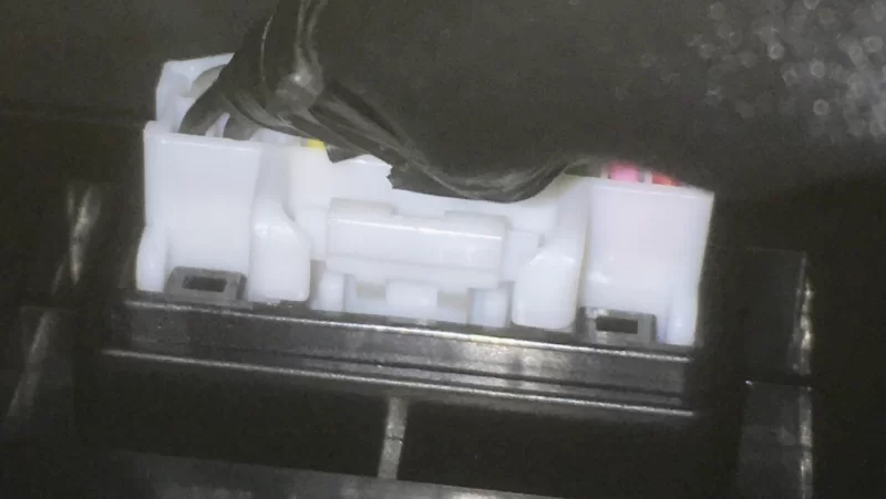

Well... the more lack of success the more determined this ol' fart got. It took a headlamp, long screwdriver, plastic tool and being somewhat of a contortionist to finally get the plug out.

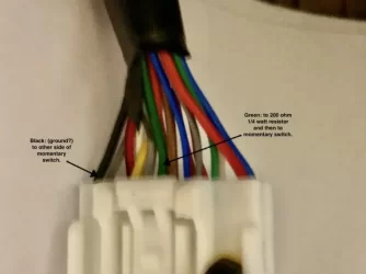

Pin 7 (tab side counting left from plug) is green and correct, I have not metered out the ground on pin 12 (black), but it should work. I grounded mine to the chassis. (through the switched 200 ohm resistor of course) ;)

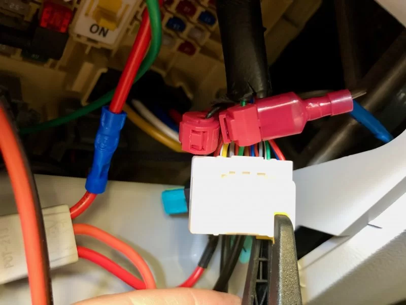

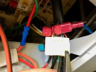

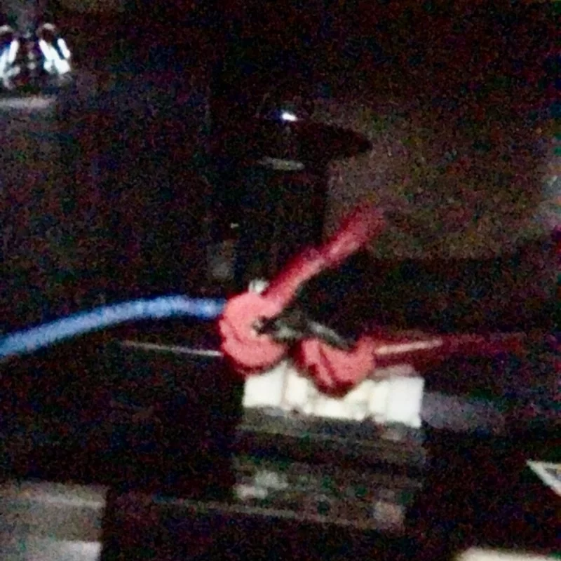

The deed is done... checked pin 12 to make sure it went to ground. Used "T" connectors to tap into green(7) and black(12). Built a little harness that had switch on one end, insulated spade connectors on the other with a 220 ohm resistor soldered into one wire and shrink-wrapped. Spade connectors plugged into "T" connectors. All good. No holes needed. Works great. VSS is powered on at each start. Press button, silence. Press again and VSS active again.
Was not quite as easy-peasy as anticipated due to the close quarters and phat hands but at the end it all worked out. Actually better than when I first posted the question because it is now on by default until I'm in a place where silence is golden.
