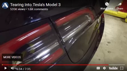

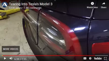

I don't seem to be able to upload a picture to my "Album" section from my Profile page, so I guess I'll have to do it by posting the photos here.
These are a couple of screen shots where, in the Munro video, they ridiculously claimed you could "barely get a fingernail in" on one side of the trunk panel gap, and "almost get your thumb in" on the other side. I'm posting them merely to show how ridiculously they exaggerated the fit-and-finish issues on the Model 3.
It looks like there could be some variation in the gaps there, but it's hard to tell from just looking at the video. It would have been better had they just showed the measurements with a tool instead of making a claim which sounds a little exaggerated.
Maybe it's just me, but it looks like it's exaggerated a lot, not just "a little".
To be fair, these photos are a lot smaller than the actual car is, so variations may be easier to see if you're standing right next to the car looking closely. The thing is, I don't think most people examine the panel gaps on cars that closely. Not even when they buy them. So who cares? Seems to me this is nit-picking to a ridiculous degree. It appears to be a case of Munro going out of his way to look for unimportant things to complain about, when the important stuff is just fine.
Just my opinion, of course.

You are absolutely right it doesn't matter a bit to how the car moves you from point A to point B. Its all about perception and perceived quality. My wife likes Hermes purses, and they are crazy expensive, some of hers cost more then a Nissan Leaf (not kidding) but when I look at them the design is simple, but the quality is fantastic. Each stitch is perfectly done. Does it hold her wallet and phone any better then a dollar store purse? nope! But she likes it, and appreciates that attention to detail. When I bought our companies last dump truck, I went to pick it up myself, and found a few scratches in the paint and an imperfection on the aluminum fuel tank. I had them fix it, and on the fuel tank they gave me a rebate because it was not fixable without a replacement. Did this matter the next day when we drove the truck on the construction site in the mud... No, of course not, but I paid a price for a new product and it should be delivered as designed and expected. I guess if you buy a quality product you should expect it to have mechanical quality and also cosmetic quality. If I bought a Kia in the 90's at 50% below typical car price I might lower my expectations, but when it is a premium product I expect nothing less then the best. In the case of the Tesla Model 3, its the corner cutting in the manufacturing process that chaffs me. My buddy who works for Space X has a very flawed car, now I am not even sure if he paid full price as he is not allowed to talk about that, or let me take pictures, but the car is far from perfect. It does run and drive every day, and he drives it to work here in Redmond, so I guess it is functional. Typically when our group of friends talk about the car he just changes the subject. His was a Oct-Nov 2017 built car, those were rough :)~
