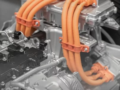

They didn't note in the video that there are cover panels they removed for those cables but it did seem like really poor routing...
Zip ties don't seem like the best choice to attach HV cables to the underside of the car. I'd think one of these moulded connectors would be cheaper and better than all those haphazardly placed individual zip ties.
The covers protecting the cables WERE removed prior to filming the video. You may want to check out this alternate YouTube video: . The cables' installation/routing/zip ties are a non-issue since they are fully protected by a cover. This indicates the reviewers in the Munro video have an agenda to slam the SE unfairly. Disappointing.

As far as the zip ties go, the concern is not so much holding them to the car or protection but vibration and abrasion over time. I've recently been involved in some shock&vib testing and it's quite amazing how much damage can be caused by just slight rubbing.
To me, it looked like there was a lot of loose unsupported length to those HV wires which can be problematic down the road (100k miles) but it's always hard to tell from just a video.

EVs have no vibration like ICE vehicles do. The suspension should keep things pretty still in the undercarriage.
That's definitely not true. The ICE engine was only one (rather minor) source of vibration, the road surface is a significant contributor. It's enough of a concern that automakers build specific test tracks and giant machines just to shake the car for hundreds of hours to see what fails:
