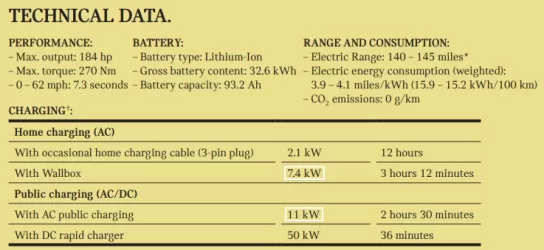

I downloaded the Technical Data PDF file from the UK MINI site @T.C. was kind enough to link. I was confused by the AC charging info. When I read months ago that the MINI Cooper SE could handle 11kW AC charging, I switched my 9.6kW EVSE for an 11.5kW EVSE. Now I see this chart from the Technical Data sheet that says AC home charging "with wallbox" maxes out at 7.4kW, but 11kW is possible "with AC public charging."
I don't know why the MINI couldn't be designed to make full use of a single-phase 11kW EVSE, but it appears the SE's 11kW charging requires a 3-phase EVSE. My old Honda Clarity Plug-In Hybrid can handle more than 7.6kW; a newer, all-electric car should be able to better that. Darn it, the 7.4kW limitation means that if I coast into my garage with no charge it will take me an extra 42 minutes to fill 'er up.

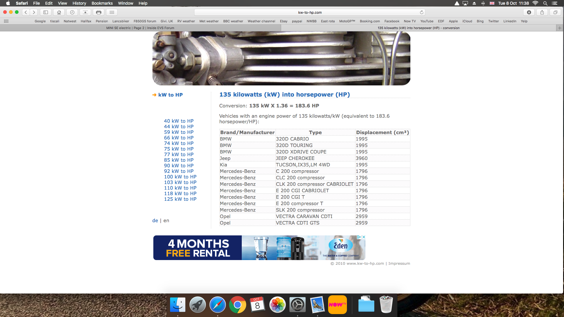

MINI should check their horsepower conversion factors. A 135kW motor equates to 181.038 hp, not 184 hp. Will we have to wait until March for the more realistic, official EPA range numbers to be revealed?
MINI and that table are using the outdated Pferdestärke number, which should be identified as "PS", not "HP."
PS or Pferdestärke ("horse strength" in German) was replaced by kW as the EU's "legal" measurement of engine power in 1992.
One PS is about 98.6% of the brake horsepower that most people assume in an apples-to-apples comparison.
HP = kW/0.745699872 = 135/0.745699872 = 181.037981993914
PS = kW/0.73549875 = 135/0.73549875 = 183.5489183360271
