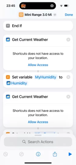

iOS 16.1 got rid of all of the permissions prompts (where you have to select the note twice! at the end), but you still have to tap the field for focus. It's a lot better, and almost back to the original usability.

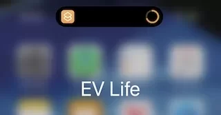

Anyone else having trouble with this on iOS 18.1.1 or iOS 18.1? It seems to hang now when trying to update the notes to save the results.
(Note the orange ring stops at about 2/3 completed.)
I used it a couple of weeks ago and I've been on 18.1b (18.1, 18.1.1, etc) since July, and 18.2b since October. I'll try it tomorrow (18.2b3) and file a report.
I discovered the issue. Not sure if the iOS update clobbered things, but my permissions were messed up and I had to give location permissions to Shortcuts to get weather and stuff. It's working fine now.
I've had to re-enable location permissions for Maps and other things, so somehow my Phone had somewhat of a reset. It's probably just me.
