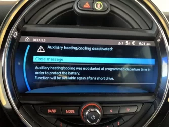

I find it strange that my car was plugged in and had a departure time set and still wouldn't climatize the cabin. Makes me wonder if the regenerative braking is instrumental to 12V battery charging.

I scheduled a departure time using the Central Information Display with preconditioning enabled today, then plugged in the EVSE.
The instrument binnacle said it would be charged to 100% by the scheduled departure time (5:15pm). The MINI Connected app said it would be done charging by 1:15pm.
It finished charging by 1:15pm, rather than "pacing itself" to finish charging right before the departure time. I haven't configured an off-peak charging time window (which this would have been well outside of), so I don't know if that's a factor or not.
At the departure time, I unplugged the EVSE and got in the car. The HVAC behaved as with my previous test: It was gently blowing "comfortable" air until I started the car, then immediately adjusted to reflect the separate driver/passenger side settings. Each side quickly achieved their target temperatures, so the preconditioning definitely worked.
Mine is working fine as well, I used it when leaving work today and my SE wasn't even plugged in. The odd behavior only occurred after a few days of not being driven. Almost as if the car was hibernating.

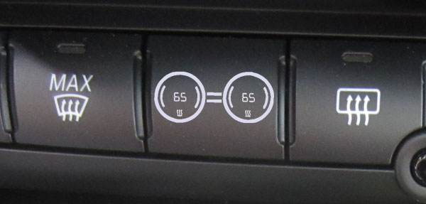

Is there a way to make the driver and passenger commanded temperatures sync? Other cars I've owned usually have a button to make them match with the driver as the master, but I haven't figured it out in the SE, and the manual doesn't mention it. OCD Scott has to have them the same unless there's a passenger.
I am also desperate for this answer for exactly the same reasons!
It sounds like the BMW i3 needs at least 3 hours to warm the battery. Has anyone heard how long the SE takes, and what it's minimum time window is? For example, if you initiate preconditioning only an hour before driving, will the Mini even attempt to warm the battery?
My current Mini hardtop (2016 with seemingly identical climate controls) does not do this. I often drive alone and adjust for the seasons. If I want them the same I change both. Max AC will adjust both. I tend to run cold and my desired temps are different than my passenger. I never realized single climate control was desired until this post. I asked my husband and he said that's how he runs his Honda. I must be the oddball lol

Another three days sitting in sub-freezing temperature (plugged in and preconditioned departure time every day), and I got the preconditioning warning again. The car didn't seem to ever wake up, the app never showed an update past the time it first hit 100% SoC.
I'm starting to wonder if I'll want to heat my garage. But the car is driving fine and it showed 103 miles and 100% power. Although it seems I'm losing 10%-15% of range with these cold temperatures. The real test will be in winter when it hits -20ºF.
