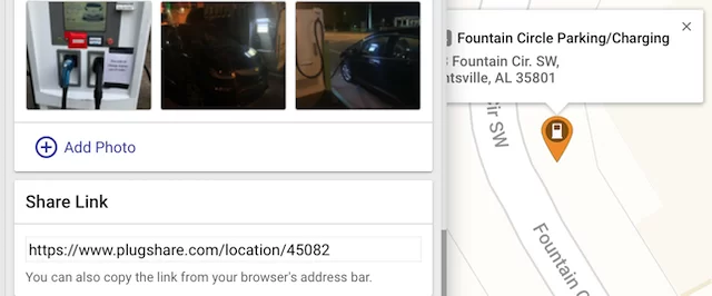

The station I use the most is https://www.plugshare.com/location/220182 but it is in California, so that probably doesn't help you much. But I love it, it is free to use and always available when I go, which given the price is shocking.

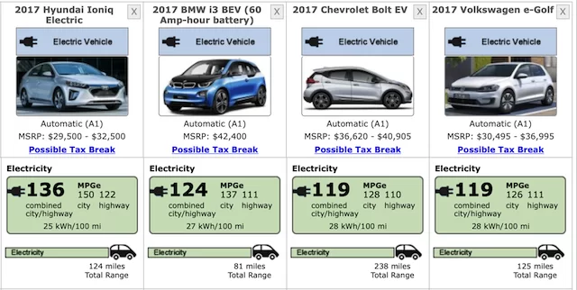

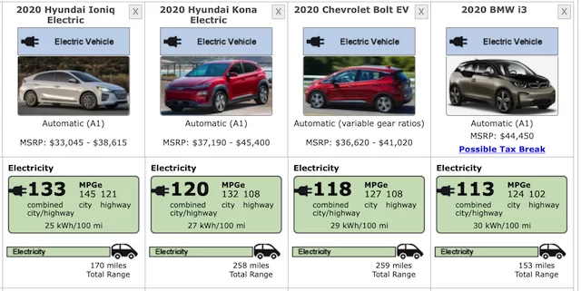

Based on that, you're in a great position for a number of different models. But based on your budget, you're going to be looking mostly at used EVs - but the good news is, they are a tremendous bargain!
Based on your mileage and budget, I would suggest the following:
* BMW i3 (with or without Range Extender). The earlier models showed a range of about 75 miles, but with the range extender, will go to about 150 miles. I've been told the newer models go well beyond 80 miles without REX. Yes, you will have to put gas in it for the Range Extender from time to time, but it's only to charge the batteries. The suicide doors give you plenty of room for three kids when needed. And the used models are an incredible discount - often dropping from 45-50k new to around 15-18k.
* Mini Cooper SE. It has a range closer to your needs - around 120 miles - and since it's still new, you'd get all the incentives which can drop it as low as 19k. However, it may be a big snug for three kids in there.
* Chevy Bolt. Right now, Costco is running a lease deal anywhere between 150-200 a month, with 200 down. Unbelievable deal! But check the details locally, as incentives will vary a little from state to state.

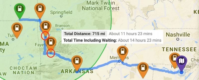

So this year, Tesla added two, SuperCharger stations with eight stalls each:
  • Lowell AR, eight, 150+ kW spaces
  • Ozark AR, eight, 250 kW spaces
We used to take a +4 hour, L2 charging session at Ozark AR to barely reach Tulsa. Now we'll charge less than half an hour at each SuperCharger to quickly reach Mom's place in Coffeyville KS. Alternately, we can go to the Tulsa OK SuperCharger to visit hometown Stillwater OK.

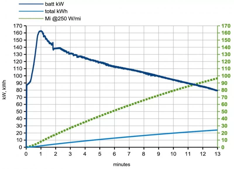

The other aspect is whether your car, ours is a Standard Range Plus Model 3, can take a fast charge:
Many other EVs have 'flat' fixed charge rates at lower rates.
