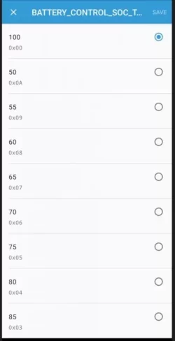

Found the charge limit in expert mode.
HU_NBT_EVO > 3000 HMI > BATTERY_CONTROL_SOC_T... > 100 (0x00)
Can you set up one of these SOC selections to be activated by a button? Would you need to use a second button to go back to 100%? Or is there a secret SOC menu that could be set up for access through a button?
I think a hot button could only control it if it brought up a selection screen in iDrive

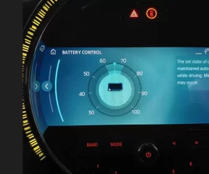

Well I poked around a few other settings. There is a battery control menu available but you can't change the settings with the iDrive controller or touchscreen.
Well poked around a few other settings. There is a battery control menu available but you can't change the settings with the iDrive controller or touchscreen.
I wonder if there's another setting to make the activated menu accessible?

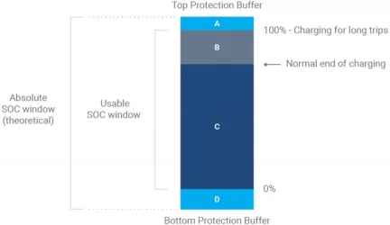

MINI chose to implement an uncommonly large top buffer. It would be very interesting to see the buffer values for all the EVs on the market.
In the following diagram the SE's top buffer would be basically "A" and "B" combined.
I don't get it. How would one go about getting the battery to charge to "100% for long trips" vs "normal end on charging"? No doubt it would be a cool feature
