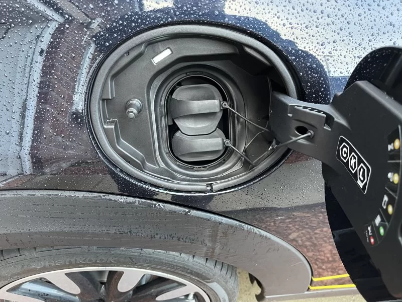

I’ve done this on my SE too and it’s brilliant for stopping water ingress into the charging port. I wasn’t concerned about water finding it’s way into the ports themselves as the covers will stop that, I was just fed up seeing water collecting in there. I went with black sealing strips rather than white to blend in a little more and coated it with silicone lubricant to prevent it freezing the charge port door shut if it gets wet and then freezes. Slightly harder to open and close the door but the photo below was taken after heavy rain.

As you probably saw, @SpeedyRS sealed his charging port very well. It appears MINI/BMW's engineers threw up their hands and conceded the battle against water getting past the cosmetic door. They designed the charging port covers to keep water out of the charging ports themselves.

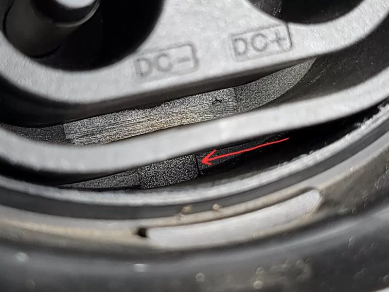

If you look at the photo @SpeedyRS provided, the water can collect below the Level 3 charging port--there is no drain hole.

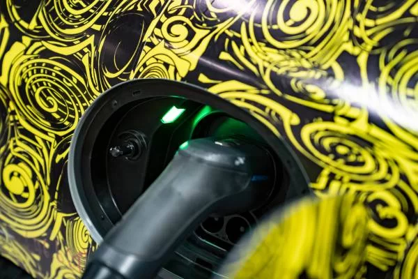

I don’t know why Mini couldn’t have copied that design; including the light strip around the port!

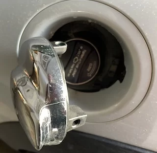

Am I right in thinking that the ICE Mini doesn’t have a flap at all though? I thought it had either a chrome or a black fuel cap only.
Previous generation MINIs only had the cap. With the current generation there's a metal door in the body just like the SE, but then a fuel cap that creates a seal on the filler tube. I'm guessing there's a "drain hole" in the sense the filler tube isn't sealed to the body. I have a first generation Clubman with the chrome cap only, but I can't check it for drainage. I never remember water pooling inside the fuel compartment.
Hah, the previous generation design fooled me. It is indeed a chrome "cap", but it's really a lid that goes over the actual fuel cap. There's not much space for water to collect, and it doesn't seem sealed like the SE's interior compartment is.
Here's a photo of my 2014 Clubman's fuel port, with the chrome "cap" opened and the black fuel cap behind it.

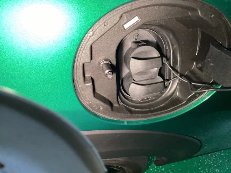

When I read the original thread about the charge port lacking a light, I laughed. How hard could it be? The joke was on me, once the MINI arrived. It was much harder than I thought, guessing in the dark, to fit the charger in the port. But then I just shut my eyes and used my hands. It's not hard to guide the charger in by feel. I'm just used to relying on my eyes.
The water collection is a bit annoying it's true. Hadn't thought of making my own seal.
This is definitely a short coming on the SE. I pull in the garage to park, and consequently do not wish to step over the EVSE cord, so I’m plugging in the car left handed and in the dark!!!
The wife’s Prius Prime has a very bright little light that comes on in the charge port whenever the port hatch is opened. It’s amazing how the smallest little thing can add significant satisfaction. OK, maybe I’m spoiled.
View attachment 15765 I did what you suggested put a 8 oz. Water there and water drains nicely than I look under a car on garage floor on top of a tire can’t locate any water next time I put a gallon to find out where a water is going? A hole is so small when you park outdoors better is not clogged.what about winter conditions? View attachment 15765
There IS a drain hole, it's just super tiny. May be worth intentionally putting some water below the L3 port and making sure it's not clogged.
You must be right. I just went out in the rain, unplugged my charging cable, and didn't find any water pooled in the bottom of the charging port area.
The tiny drain hole must have become clogged with ice when it was colder and I found rain frozen in the bottom of the charging port area. I'm pulling out my 1/4-inch drill bit tomorrow ;)
