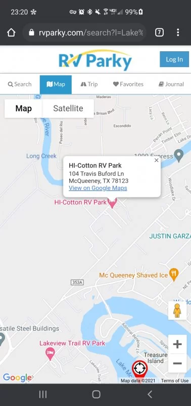

I think I posted this in the EVSE section, but since it is germain to this discussion:
rvparky.com is a nice resource to find RV parks where one can charge an EV, assuming one has an EVSE that has (best case) a 14-50 plug, (odd but still useful) a TT-30 plug, or even (so slow, but beats going dead in the water) a 5-20 plug.
I once stayed at a VRBO house whose wiring was old two-wire, meaning my planned trickle charging was a no go without a ground. By happy coincidence, there was a tiny RV park hidden half a mile away, and so I was able to pay the owner $10 to charge up the afternoon before we packed out.
HI-Cotton RV Park
(210) 374-2780
https://maps.app.goo.gl/aAYR6NnUnKgEojWL7
HI-Cotton RV Park
(210) 374-2780
