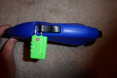

I used the TSA lock because it fit the small hole in the charger. To fix the problem, I just filled the key hole in the TSA lock with 5 minute epoxy. The combination part still works. Thanks for the heads up on TSA locks.
Do you have the make and model of the lock? Have been trying to find a lock that has a shaft that is long enough and the diameter thin enough to use on the charger. So far haven't found anything that fits.
Cable based locks used for backpacks & luggage also work
