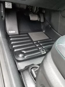

Thank you! BTW, in the picture you sent, it appears you have 3 layers of aftermarket floor coverings happening there. What's the scoop?
I use Torque and OBDLinx MX+ with my Niro EV. The OBD port is to the left of the steering wheel about midway down the lower dash. I am attaching a picture in which you can see it in the top left corner (though I wasn't focusing on the OBD but rather my floor mats) and here is a link to the OBD Device that I purchased on Amazon. https://www.amazon.com/gp/product/B07JFRFJG6/ref=ppx_yo_dt_b_search_asin_title?ie=UTF8&psc=1
Can ABRP sync with this device? Just curious; I know you use ABRP from your previous posts...
No layers, just one all weather mat. I ordered from Tux Mat and so far I am loving them. I have only had them about a week though so no word yet on the long term durability.
