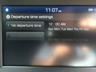

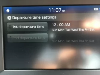

On another simple 32 amp public EVSE (untethered) it always works fine. Be sure there are no departure times enabled, that caught me out for the first month of ownership as it would start after a few tries anyway so I didn't look further.
Charging settings, I recall. The second photo shows the departure time not set, you touch the button to toggle the blue bar. I don't think this is in the manual.

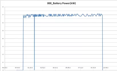

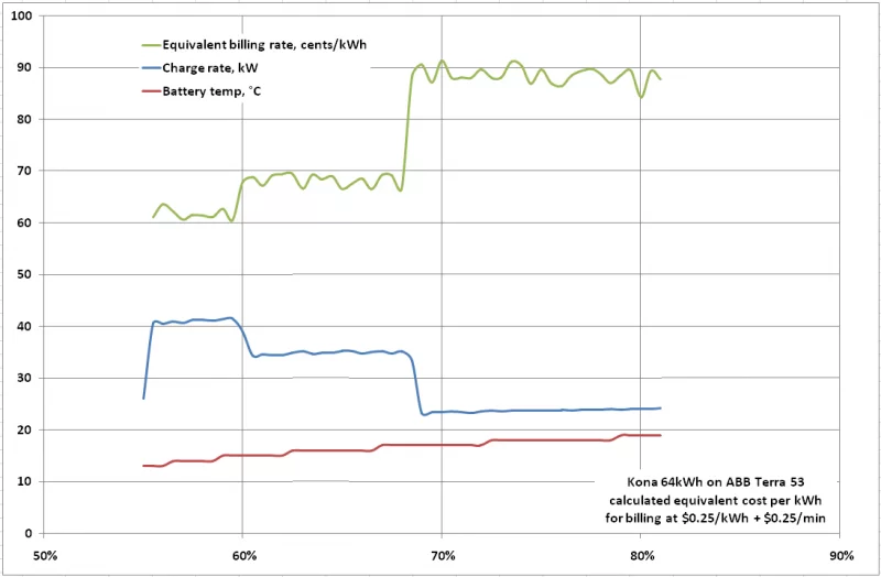

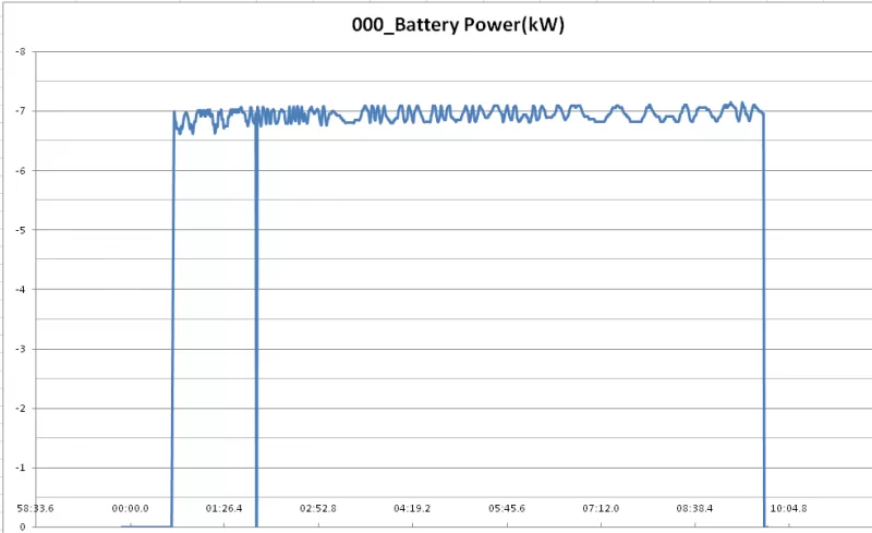

Images below are DC and AC. The glitch in the AC trace is from opening the door to get in after starting.
Once charge rate hits 22kW ,high cost, better get out of Dodge. Nice to see level temp (small increase) while fast charging. What was the ambient?

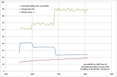

It would be a good idea to "get out of Dodge" when that charging rate hits 22kW with that billing system.
Good to see the pack temperature is constant (slow increase) throughout the charge, What ambient was this done
Edit - I see what I did wrong, added to your quote : sorry
Ambient was about 12°C ... certainly starting at 55% was not ideal for that test as warming due to charging could not be exploited until it was too late, but on the other hand I was trying to highlight the downsides of time-based billing because our government puzzlingly is looking to hit EVs owners with distance-based road taxes.
Great example of time based billing disadvantages.
