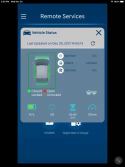

Fairing relatively well with our 2019 (that had a battery replacement last month).

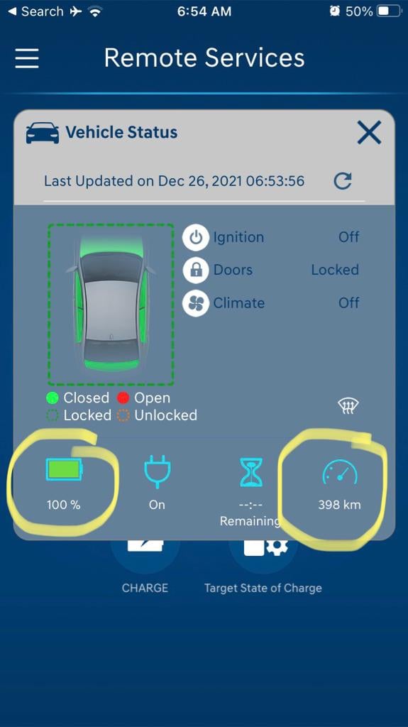

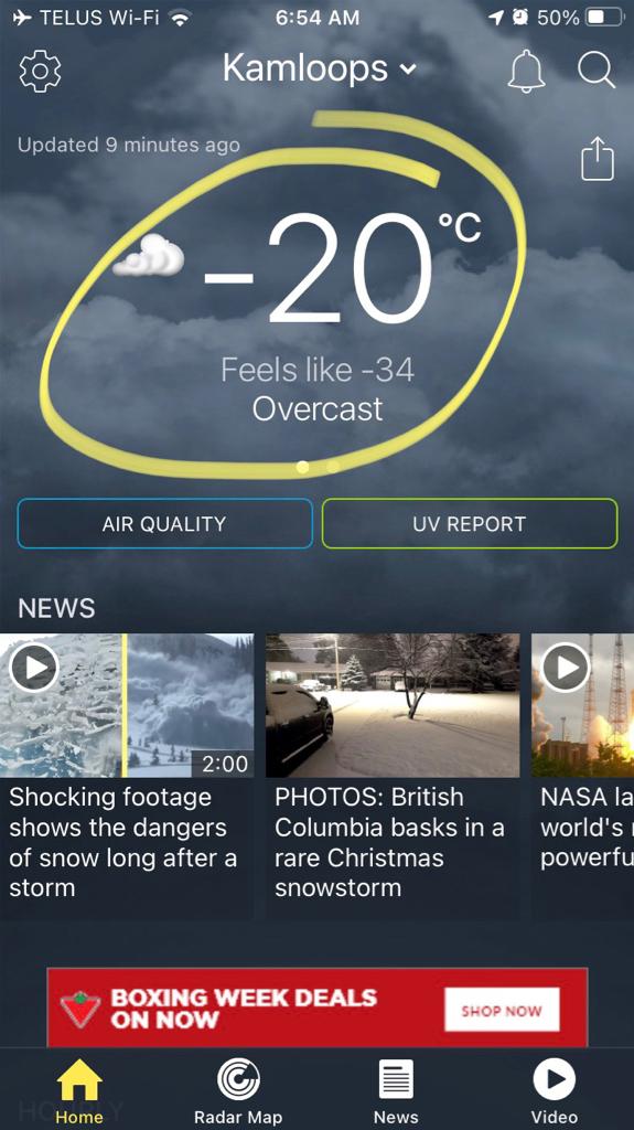

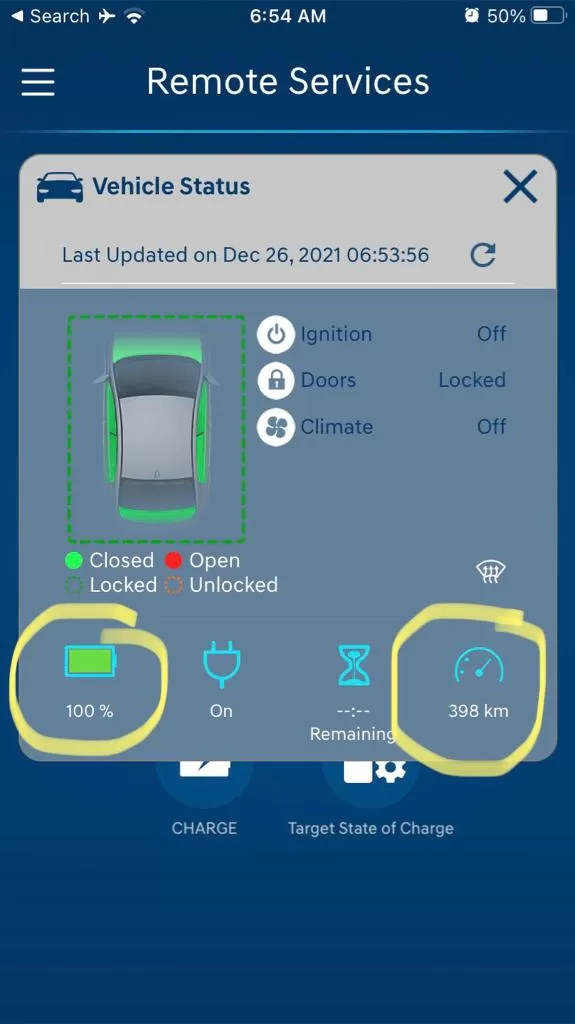

The problem is posting your just your GOM range in no way represents reality.

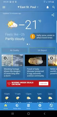

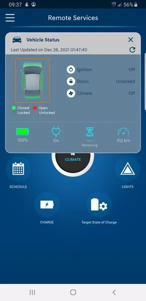

This is my current temp and GOM reading -21 and 312km(based on recent highway cycle with heat off). I know for the fact despite what GOM claims if I drive 100km/hr with no headwind and driver only eco heat set at 21C auto, the best I am going to do is around 230-260 km on a full charge. The best way to provide your actual winter range is drive a reasonable set distance with a realistic climate controls settings so at least your windows don't frost over assuming similar driving variables of speed, temperature, headwind, road conditions, etc and multiply your average consumption of miles or km/kW x 64 . Again, GOM readings are otherwise meaningless.
Oh, as a side addendum if you park your car outside in the winter your urban cycle range for short trips is not going to be much better as as the major EV advantage of regenerative braking is significantly reduced at -21C compared to summer temperatures.
