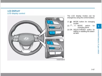

From looking at the the graphic in post #7 above, have you found and repeatedly pressed the MODE button on the steering wheel, while watching the console display?

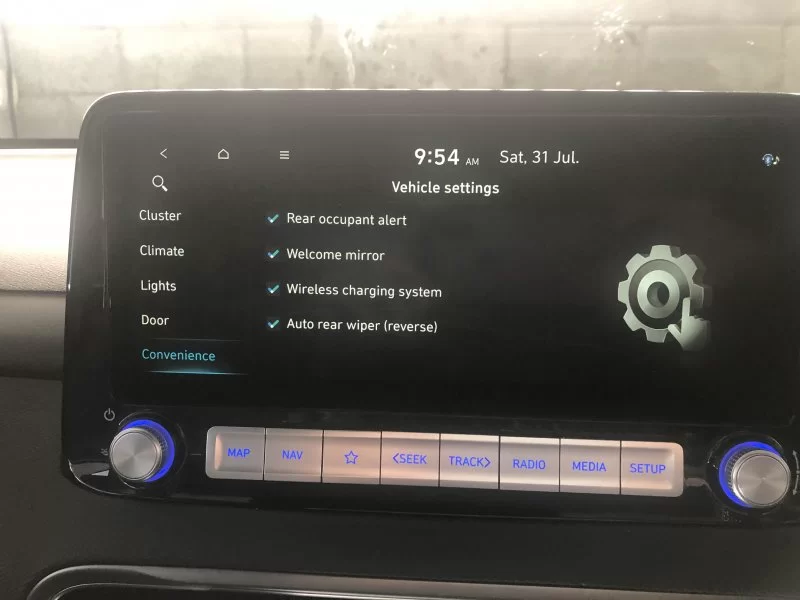

On the centre screen
Setup > Settings > Vehicle > Convenience > Wireless Charging System > Check box

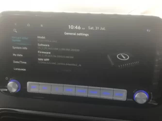

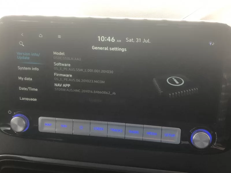

Well isn't that a lot better, they must have changed it. All I have is drive mode and climate (21 Kona EV Ultimate Canada). I wonder if this feature included on the 22's or if the new software "update" changes this menu on the N.A. 21's. What Nav/Media version are you running? (of course it won't be N.A.) but just curious if you still have the 3 screen home set-up.
Is this the information you are looking for, electriceddy? This is just straight off the phone camera so I hope you can read the numbers. If not I'll edit the image.
The screen divides 2/3 1/3 with the smaller pane on the right.
No reason to edit, I can read it just fine. Thanks for the photo.
Maybe someone will tune in and report if this updated vehicle settings menu (minus the welcome mirrors of course) is included as well in the newer software in N.A. 21 models c/w version#. Hopefully that solves @TD2021 issue with a 22 model.
I am still running the original 3 screen home set-up, unwilling to nuke that until improvements have been reported - but this would definitely qualify as one of them.;)

For clarification, there is no Bluelink or OTA capability on my 2021 built Kona. It's not a feature that is offered. So maybe my route to managing wireless charging is different from what is supplied in North America. The 2018 built car manages it from the steering wheel controls as was shown in Anaglypta's post #7. Maybe time for me to butt out of this conversation and not be confusing!
