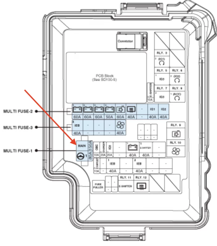

Any idea where the location of this 150 A fuse would be? Diagram (or picture) would be useful:)
Ah, now that you made me look, it's not in the HV junction box where I thought. And of course it wouldn't be because it's 12V, not HV.
Under the hood:
