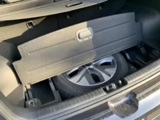

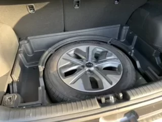

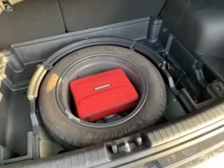

After encountering an unrepairable flat on a lonely stretch of FWY and frustrated about the limitations of no spare and a temporary spare, I found an OE wheel online and I now have a real spare. After 3-4 months, I’ve seen no discernible reduction in range. (The heater, on the other hand ...)
The photos show you can store the wheel flipped either way and that you can cover it back up. (Leaving all the cover supports surrounding tire unfastened allows this placement to work.

Paz, could you please expand on "leaving all the cover supports surrounding the tire unfastened," please? Did you unscrew them so they're just sitting in the well? Thanks...
Yes, they are all in place but not screwed down. I believe they could be, but I’d need them to flex a bit to pull out the spare.
Actually, I’ve been driving on the spare since I got It; a couple months now. I wanted to test everything (new jack, handle, spare) so i changed the tire and just haven’t made the time to change it back.

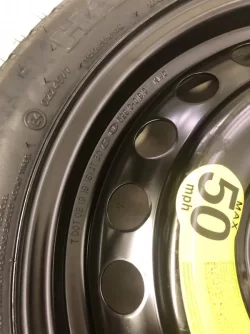

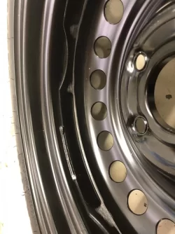

I ask because I recently had to use my compact spare and it was rumbling when I drove. When I got my tire replaced, they told me the spare was not the right one for my car and was scraping my brake caliper. There are scratches inside the rim that show it definitely was hitting in spots (see pics, third one to show part number on the rim). Upon talking with the dealership parts department, despite this car having 17” wheels, the only compact spare offered by Kia for the Niro is 16”. So they basically said they can’t do anything for me. They claim it won’t damage the car other than cosmetically but seems negligent to sell a spare that doesn’t properly fit.
I urge anyone who got the compact spare to check.

I could be wrong, but I thought I read somewhere the spare tire kit has a limitation with the EV model in that it won't fit the rear axle correctly because of the size of the EV's rear axle brake calipers, and that the workaround is to use it only on the front axle. Which unfortunately means if you have a rear flat, you need to first replace one of the front tires with the spare and then replace the flat with the removed front tire.
Guess that scenario is still preferable to having to get a tow if the tire sealer kit will not work, and then trying to find a replacement tire, which I would not expect the average garage or tire store to have in stock ready to go.
huh, no idea where you heard/read that? I did put it on the rear and now I’m curious about this theory of it fitting on the front…would certainly be a pain in the butt with a scissor Jack on the side of the road but better than the drive I had with it on the rear.
This is not where I saw it, but the attached seems to confirm it and seems to offer an alternate solution:
http://techno-fandom.org/~hobbit/cars/ev/donut/
I could be wrong, but I thought I read somewhere the spare tire kit has a limitation with the EV model in that it won't fit the rear axle correctly because of the size of the EV's rear axle brake calipers, and that the workaround is to use it only on the front axle. Which unfortunately means if you have a rear flat, you need to first replace one of the front tires with the spare and then replace the flat with the removed front tire..
I read the same thing someplace in these forums. Seems plausible. The EV is significantly heavier. Might have needed a beefier braking system to meet stopping standards. This is the kind of thing that happens when a car is an ICE made into an electric instead of engineered from the ground up. I love my Niro, and this is just the way it is...
