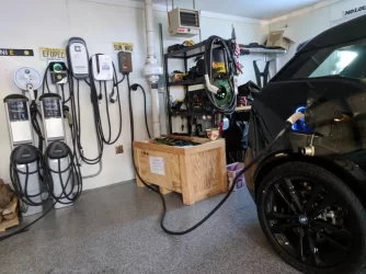

I'm glad you got it to work, bfd. For what it's worth, I have three JuiceBox Pro 40's and I've never had a problem. I really don't think people here should be concerned about getting one. It's really the only "smart" EVSE on the market, so with more features there are likely more things that can go wrong.
I've been reviewing home charging stations for about six years now (many of which are posted here on InsideEVs) and eMotorWerks has grown from a startup to one of the biggest suppliers of home charging stations, so they have naturally had some growing pains. That said, thier customer serives has been outstanding (so is Clippercreeks for that matter) recently, and they are quick to send you out a new unit if there any trouble. I wouldn't recommend a station that I didn't have complete confidence in.
I actually just posted a new review of the JuiceBox Pro 40 yesterday, so I'll post the link below if anyone is interested. Also if anyone has any questions, feel free to ask!
