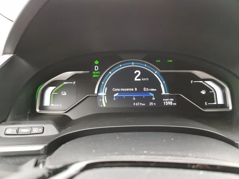

I’ve actually had my first ´frozen in ICE’ behaviour yesterday with 75% charge. 4400km on the car.
Stuck in traffic, the meter stayed white until I was way past the traffic and only turned back to blue when I was close to home and I kept switching HV, sport, econ over a period of 25 minutes. Way longer than the normal engine cycle.
At very low speed I think the engine was off (it does show EV) but it would turn on when moving, engage the clutch, etc.
Maybe this was my first ICE maintenance cycle.
Maybe. I have had that happen to me once. It certainly isn't common behavior, but maybe necessary once in a while.
And you have all that ev range it is showing, too. My Clarity hasn't shown above 44 miles ev range yet but my engine rarely comes on. You are also showing only 200 miles hv. Did you get the hv range update already? If you haven't that would also be weird.
The tank is not full. About half. I only put in about 3 gallons a couple of weeks ago.
