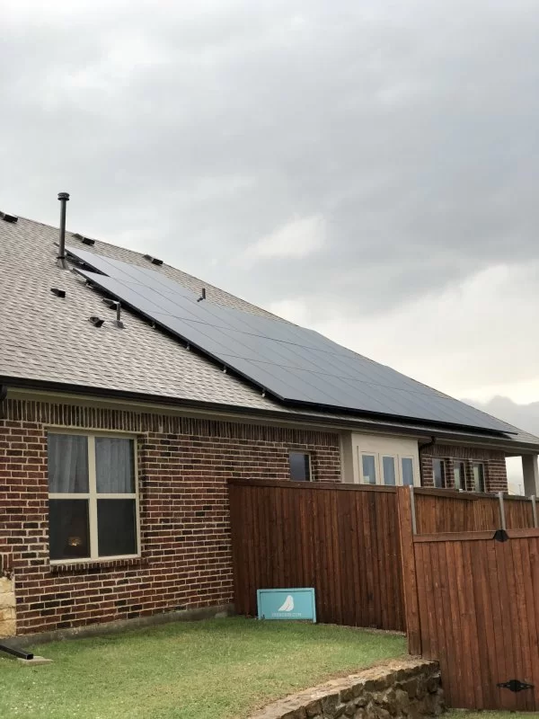

I picked SunPower for micro inverters, panel and mounting esthetics, and warranty.
