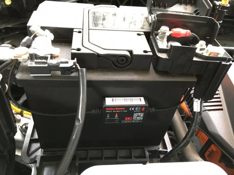

I bought this item because I noticed a UK owner had one on the SpeakEV forum. It's a voltage logger for a 12V car battery and is connected permanently across the posts, drawing a mere 1mA. It logs voltage to internal memory every 2 minutes and overwrites old data after 31 days. That data is accessible by the free app (both Android and iOS) when in Bluetooth range and is displayed on a graph in 24 hour segments, which you can screenshot. A cursor is available as well but there is no apparent way to download the data.
While using the app within range it updates and graphs every second. There are configurable low 'SoC' alerts as well but you have to be in range to get them immediately and so that feature may not be that useful for me, along with a couple of other inapplicable ICE-related options.

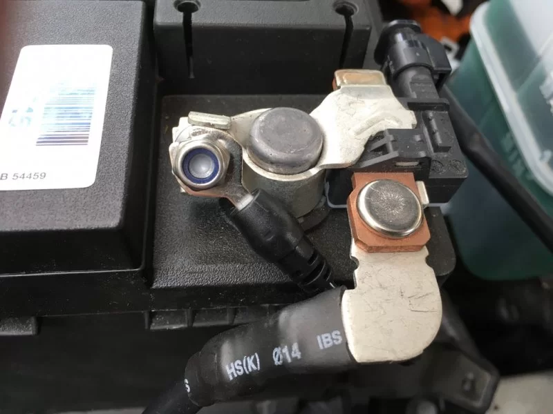

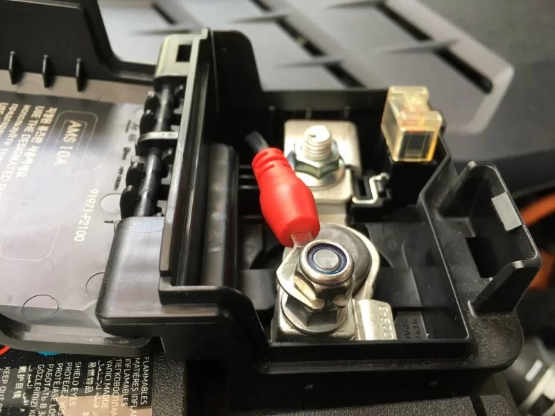

The logger is found on eBay as BM2. Fortunately, the install is an absolute breeze on the Kona EV and does not require loosening the post clamps, although you could do it that way. All I needed additionally were (2) M5 low-profile nyloc nuts and a small lump of Blu-Tack. The existing post clamps have just enough exposed thread to attach the spades on top of the clamps nuts. Using nyloc nuts assure they will not go astray if they happen to loosen. The spades need to be squeezed together carefully to encompass the 5mm stud. Obviously the Blu-Tack is used to secure the logger onto the battery but any other means is just as valid. The leads are solid core wire so you don't want to leave it hanging.
After installing the app I did not enable location access while not using the app. They say that's so it can connect automatically when you are within range and it's needed for the alerts.
I'm hoping to use this to characterise the 'aux battery saver' function and other conditions when the OBD port is not available.

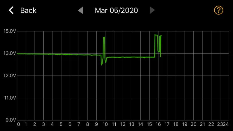

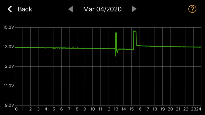

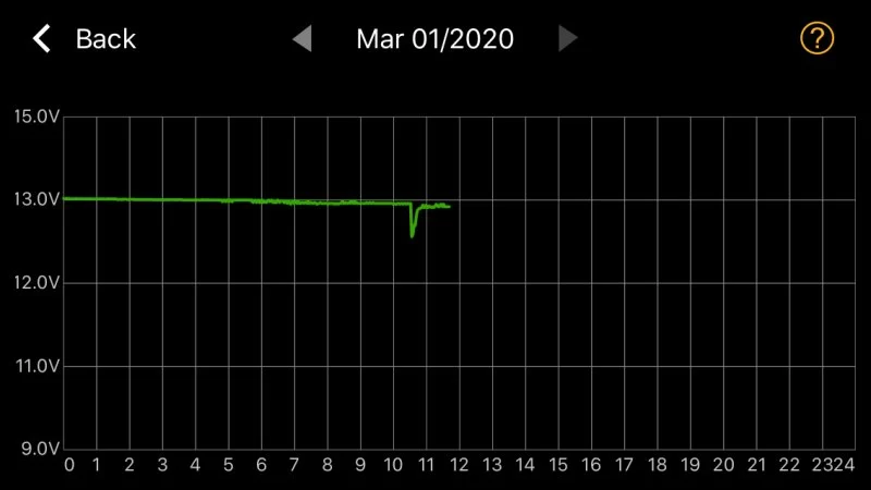

Here are some graphs. On the first, actual Kona data starts at the far right, where an AC (7 amp) charge event started at 2100 hours, which I knew would take just under 2 hours to complete, noting the little glitch. The car had been sitting for 5 days unused. You can see that the aux battery was charging for the first 30 minutes. I'm assuming that the ~13 V was 'surface charge' as they say and that when I unlocked the doors the next morning at 1030 that was partly depleted.
Note that the 'aux battery saver' did not kick in overnight, as I might have expected.
Several further notes:
The app connected directly to the logger without having to 'pair' it in the phone settings.
There doesn't seem to be any way to erase data.
Disconnecting the unit is the reason for the 9.0V portion from 1530 to 1600 after I benched-tested it.
Both iOS and Android apps seems to have the same features.
Data is read on the fly by the app off the logger, it doesn't appear to save anything on the phone or tablet.
The voltage reading matched my DVM to within about 0.05V.
I would suggest rather than your blu-tack, that 2 pairs of velcro buttons, each half firmly glued but peelable, would ensure your BM2 monitor can't shake loose from that position. Also good for tightening up vibrating panels...
I don't see any fuse in those terminals - that could be a fire waiting to happen
Been watching this thread to possibly use a BM2 other cars. I noticed too, no fuse. Presumably (?) there is some fuse type protection in the box, but that will not help if the pinch or crimp is between the box and the pos. battery terminal. Is there a small fuse that can easily go between the pos. term and this lug? Or, maybe better to tie it into the fuse box on an always powered fuse?
Are people who have used the BM2 satisfied with it? It is the first dedicated 12V logger that I've seen at relatively low cost.
As an experienced design engineer I'm well-conscious of safety and I would not have installed this had I been unsure of its quality. The manufacturer has a website with numerous battery care devices that all look very well made, and they also make EV charging equipment. The docs say it's protected and just to confirm that I've sent them an email.
Noting that the common way voltage is measured is via a resistive dividing bridge, filtered and feeding an analog input to the microcontroller, I suspect that even if there was an internal short and no other protection the PCB trace would just burn up and barely melt the case, rather than create a fireball that might leap around under the hood to whatever might be combustible.

Agree that the something in the box would likely vaporize in a short circuit condition. However, the problem might be the positive wire from the battery terminal to the box. It would probably just vaporize too, but I'm not sure that is good safe practice. Some kind of tiny fuse element at or very near the pos. terminal would be better. Unless the wire gauge is so small in the pos. connection, that the wire opens before the plastic insulation burns? (where the short is to the pos. wire, before any protection in the box)

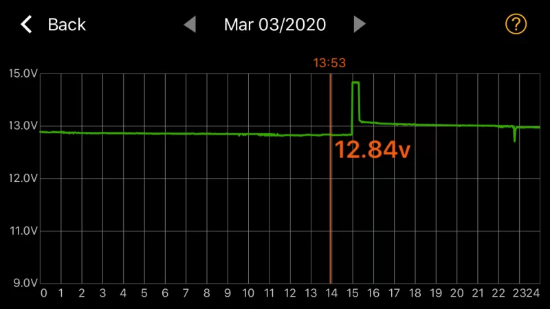

Three days of 'aux battery saver' charge events starting the first day the Kona sat unused. About 18 minutes duration each with a 24 hour gap from previous charge stop to next charge start, noting that the time resolution is 2 minutes. Other voltage glitches are due to unlocking the doors and entering Run mode but not driving, which did not seem to disturb the charging schedule. The charge seems to leave the battery at about 13.0 V then the voltage appears to run down at a rate of perhaps 0.12 V a day. My car has no owner-added loads other than this logger device.
Will be interesting to see what others come up with, particularly if imposing an external drain on the battery causes a correction in the schedule or duration.
About 14:59 to 15:17, 18 min
About 15:17 to 15:35, 18 min
About 15:37 to 15:55, 18 min
