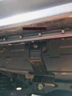

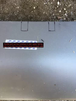

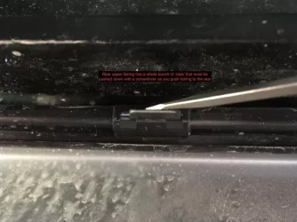

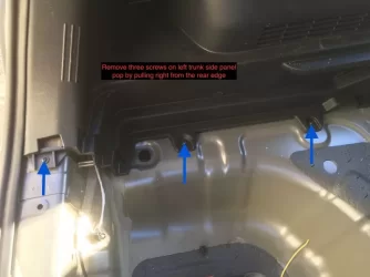

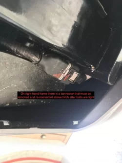

Hi, it’s now 2024 and I want to install a hitch on my 2019 Kona EV the photos are a great help.Thanks so much for this![]()
Any advice on which hitch to order?

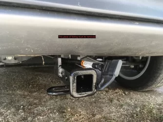

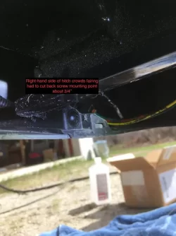

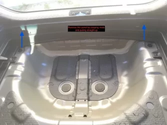

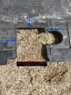

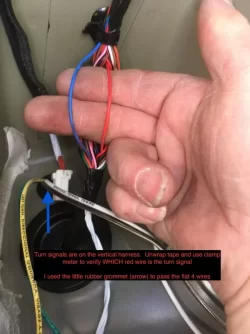

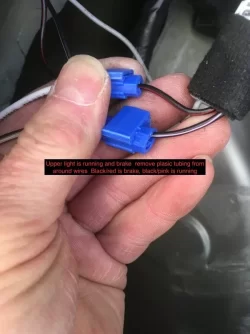

I detailed installing a Draw-Tite #24976 hitch on my 2019 Kona. The posts started on May 5th, 2019 in this thread. It has worked out great. Good luck!Hi, it’s now 2024 and I want to install a hitch on my 2019 Kona EV the photos are a great help.
