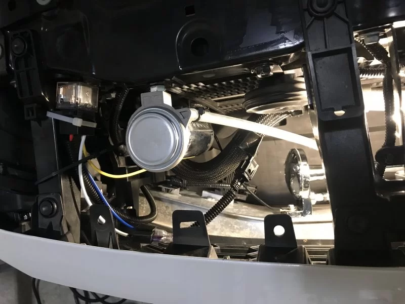

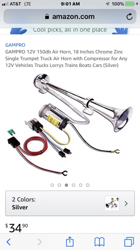

I got tired of the wimpy horn and saw a YouTube video on some guys startling unsuspecting people with a diesel train air horn. A little Googling found a real diesel train sounding air horn was way too expensive and took up too much room but I found a single air horn for $35 on eBay. And boy is it loud!
There’s a lot of cheap crap from China, but this one seemed of decent quality (all metal air pump) and came with a relay and fuse for plug and play installation. It was easy peasy by ordering the horn adapter from Honda that plugs into one horn connectors and adapts it to 2 spade lugs. No soldering at all; just wire it in place of one of the horns using the Honda adapter and run the fused wire to the pos battery terminal and the neg wire to a ground. And all the spade lugs in the horn kit are silicone covered. I went over board and used plastic wire loom on the wire going to the battery. I also used zip ties on the friction fit of the hose to the horn and pump.

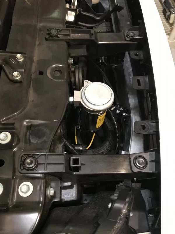

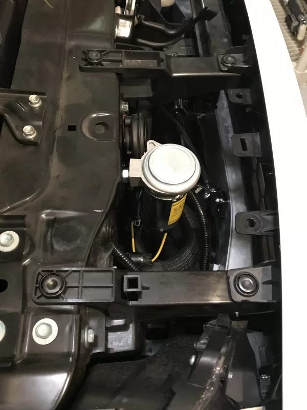

By removing the left horn, I was able to use a carriage bolt and nut to secure the pump in the same threaded hole the left horn came from and zip tied the relay to a plastic frame member.

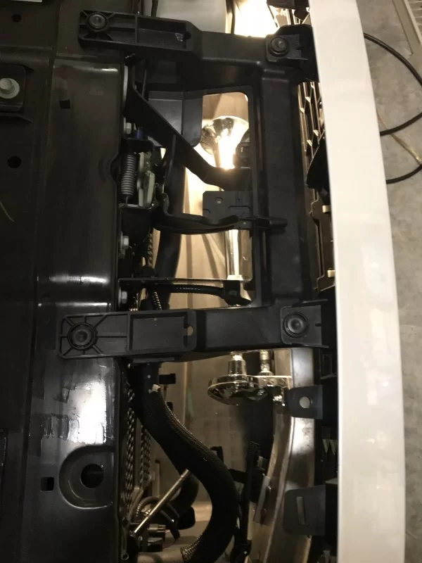

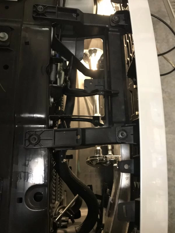

The horn was a little trickier to get installed. I used a right angled drill to reach in front of the radiators and drill 3 small holes to mount the horn on the aluminum frame member that runs across the front. Not much room there but it can be done if your arms aren’t too big.

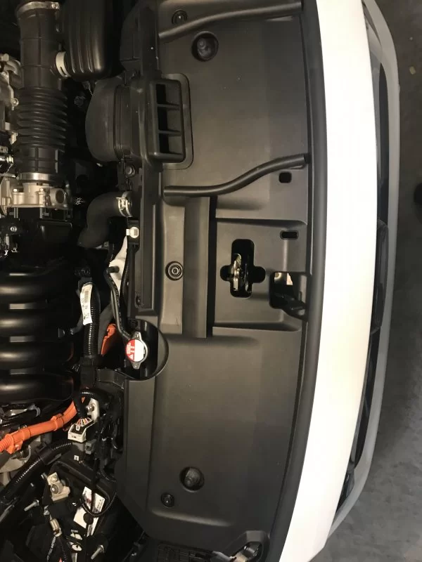

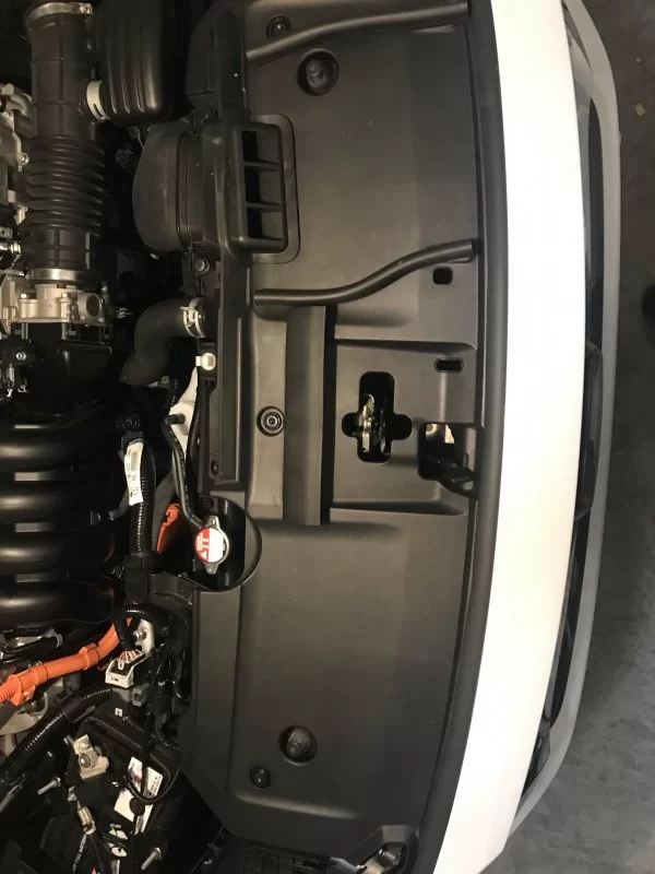

To start, you have to remove the black plastic trim that covers the area between the radiators and the front body panel. To get to that you remove a trim piece that holds down the air intake and then move the air intake back. All the fasteners are the pop up button cap kind (or whatever you call them). You can buy a tool for $6 or just carefully use a screwdriver to pry the cap up. Then lift up the large cover that will now be held on just at the bumper side by some friction plugs. Then it’s just mounting the horn in a hard to reach area, hooking everything up, fishing the fused wire over to the battery and finding a good ground for the neg wire. Fortunately the pos battery terminal has a separate bolt under the plastic cover just made for this.

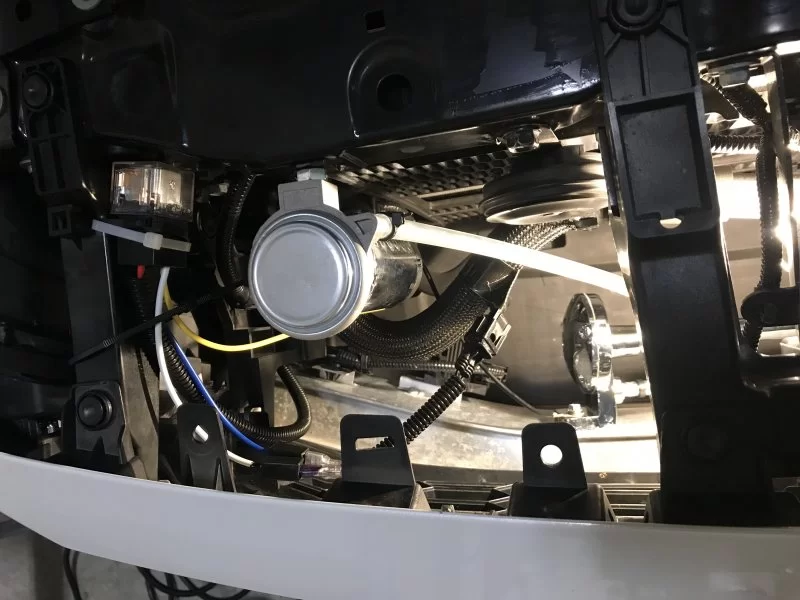

This shows the pump to the left of the other horn and the relay zip tied to the frame at left. Fearing corrosion, I sealed the bottom part of the relay where the wires enter with some silicone caulk. The top clear part houses the actual relay components and is replaceable.
I ended up mangling two of the plastic fasteners and ordered a whole box of assorted ones from eBay for what two would cost from Honda. I’ll be happy to send a couple to whoever needs them.
I also got lucky and had a couple of short carriage bolts that fit the threaded hole for the horn and the fitting on the pump, and can send one out if you can’t find one and a nut from the hardware store.
The only trick I found was identifying the pos vs. neg horn contacts. I did that with my trusty cheap and free Harbor Freight VOM. Just mark the one that shows continuity to the neg battery terminal after plugging in the adapter. Then just plug in all the spade connectors according to the instructions.
As a side note, this exposed the HV battery system coolant expansion tank (page 480) that some have speculated takes some special dielectric coolant since it goes to the battery pack. Well, it has the same color and smell as the fluid in the other two expansion tanks, so I think it’s just regular old Honda long life coolant type 2.
Also I noticed the radar has a screw adjustment for up and down just like headlights but seems to use shims for L to R.
Here is the cover back on and you can’t tell it was ever off.
If anyone wants to try this they can PM me with any questions and I’d be happy to walk them through it over the phone. Except for installing the large air trumpet in a hard to reach area, it’s really quick and easy. And I took a ton of pictures if anyone needs them.

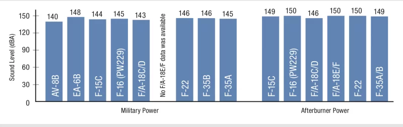

What are the sound levels like in the cockpit? What hearing protection do you use/need?
Cockpit noise is mostly due to wind over the canopy. I don't recall the cockpit noise levels or frequencies anymore - I believe it was around 100dB. The helmets have ear cups to provide hearing protection plus hold the radio speakers next to the ear. Most pilots would also wear yellow foam ear plugs - I liked the plastic plugs. The disadvantage of also wearing plugs was you had to turn the radios to max volume to hear the calls. When the F-22 came along noise cancelling feature was introduced to the helmets. On the first test flights the noise cancellation was wired backwards so instead of being 180 out of phase it was in phase and doubled the noise.

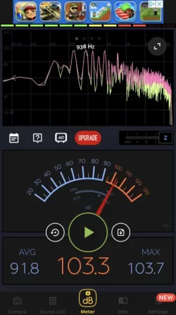

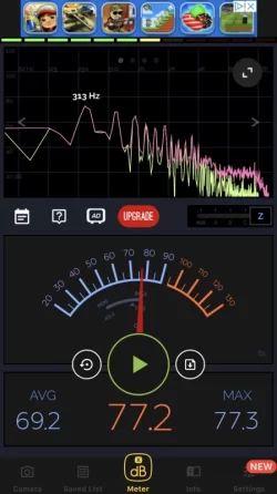

OK, here’s my reply to the posts concerned with whether or not my cheap air horn is terrorizing people or endangering their hearing, neither of which I am inclined to do.
I knew when I bought this for only $35 that it wouldn’t really put out 150 dB to some one 10 feet away. (You get what you pay for folks) I just wanted something better than the pathetic Roadrunner “meep-meep” horn the car came with.
So here are screen shots of the sound levels using the free Decibel X app on my iPhone 7.
I can tell you that the sound proofing on the car is quite good with the horn volume greatly reduced inside so no worries there.
Inside with windows up: 77 dB
Outside, I took the measurement standing as close to the hood as I could as I reached in the open window to honk the horn.
That’s only 103 dB but still quite loud and I only use a short toot at pedestrians which is not as bad. Only idiot drivers get the full treatment.
So please give me a break.

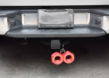

A couple of weeks ago I saw a diesel VW Beetle that had a 3’ tall, 4” diameter smokestack protruding from the hood that actually spewed smoke. That might be a great mod for a Clarity with a train horn, although one would need to have the ability to generate smoke, or maybe steam. Of course the look wouldn’t be complete without a set of balls hanging off the back.
Wouldn't those balls require a warranty-voiding trailer hitch? However, the smoke stack, train horn, and trailer hitch would be fine for Clarity owners who didn't purchase an extended warranty.
I wonder if Lionel sells this in a gallon size?
Certainly the balls could be attached elsewhere.
Does the installation of a hitch void either, or both, the factory warranty or the VSC? Or, would an owner need to actually tow a trailer to void the warranty?
All the ones I've seen have been on the trailer hitch, but googling showed they can be attached to other locations.
While googling, I found a set of truck nuts made for places (South Carolina) where it's illegal to display on your vehicle "any sticker, decal, emblem or other device containing obscene or indecent words, photographs or depictions."
