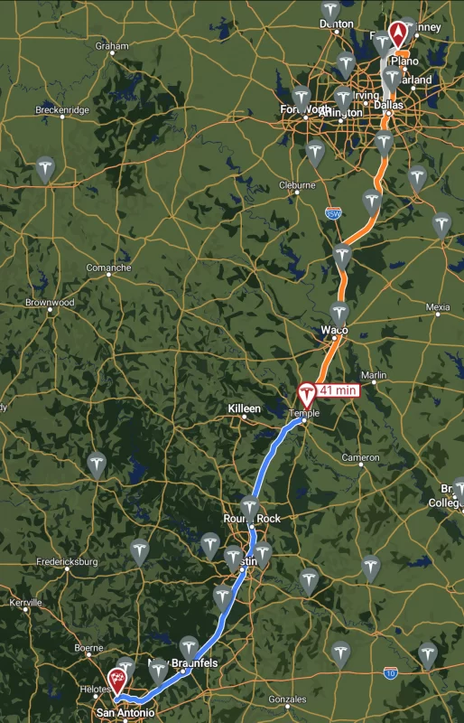

Congrats on the deposit, and yes the BUCEES at temple TX just open I believe 47 SC, that is a bunch. ABRP already shows it so like a trip from PLANO to San Antonio, with a M3 SR+, supposed to be a one stop of 40min, but if anyone stops at BUCEES, it always take that amount of time, even with a regular ICE car.

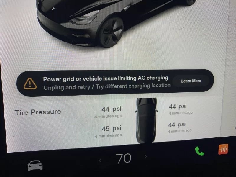

Hey Domenick I just bought a 5xxxx VIN 2018 Model 3 LR RWD used as well a month ago and it’s giving me (I would wager) that exact same charging reduced warning yours is. It says something like “check the circuits charging the car or the car itself” or words to that effect. For instance we had to drop our current down from 40 amps to 32 amps. This was with a ChargePoint Home Flex going through a Tesla sourced adapter rated for I think 40 or 48 amps. And I know for a fact it wasn’t the supply equipment to blame because I was able to borrow a friend’s 2022 Model Y LR and do a test charge in my garage with all the same adapter and everything and received no warnings or errors. Definitely I’m scheduling a service call with my local Tesla Service Center and I think you should too as Tom urged.

Yes, it sounds like we are both experiencing the same issue. The message that pops up on the screen says "Power grid or vehicle issue limiting AC charging Unplug and retry / Try different charging location"

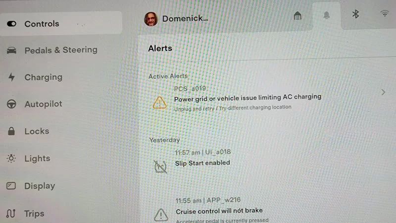

Then, if you go to the car screen, under alerts it will say the same thing preceded by the code PCS_a19. PCS refers to the power conversion system.
That system consisting of three sets of electronics which each handle 16 amps of input. If you can still charge at 30 amps on a 48-amp circuit, you still have two functioning sets. If,like me, you can only charge at 16 amps, you have two sets down.
I have a mobile service technician headed this way now to swap out the rear wire harness (for free under recall), and I will mention this issue when he arrives.
Yep I exactly can charge 30 Amp on a 40 amp circuit so it sounds like I’ve got the exact same issue. Here’s the screen grab off of mine. I’ll schedule a service appointment at the local place. I don’t think they do mobile for us since we are less than 10 miles from them.
We don't have a service center here in Tallahassee yet (soon!), so smaller issues, at least, get mobile visits.
The tech suggested I open a ticket and let them do a remote diagnositic ($175 an hour) and seems to think it's an issue with the house. The reading I've done strongly suggests it's the PCS. I'll try charging at a different house with the UMC (they can't even discuss what happen when I use my non-Tesla home charging unit) and see what happens. I really can't afford to spend $175 unless it's definitely necessary right now.
