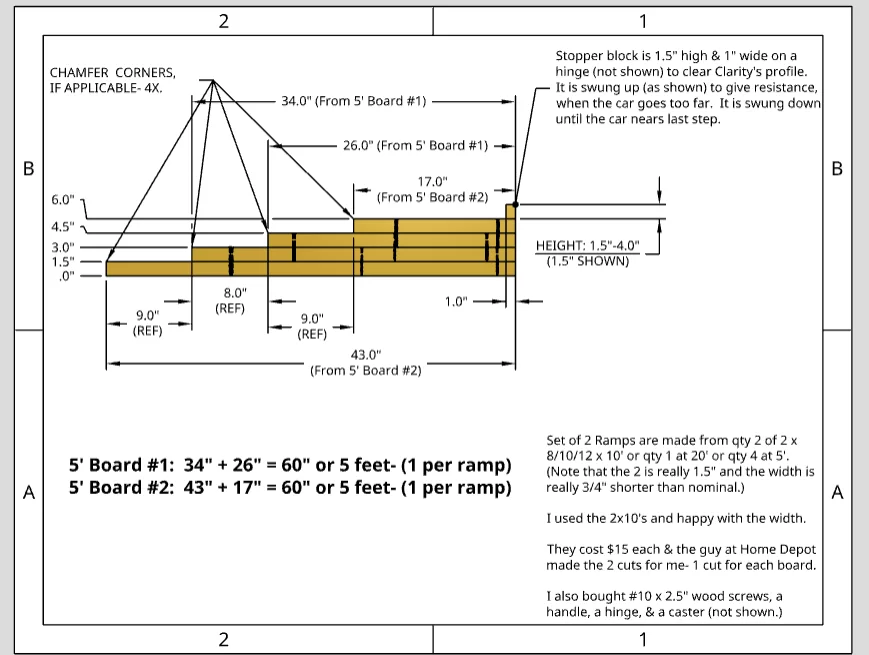

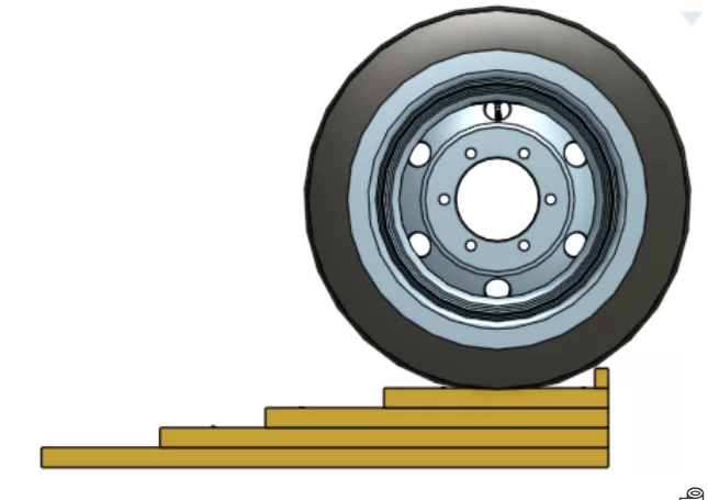

In all, it will cost around $18 (for the 7.25" wide version) or $32 ( for the 9.25" wide version) or $40 (for the 11.25" wide version)- see links below for the exact wood and pricing in Southern Californian Home Depot prices- in materials to build this ramp (unpainted.) Keep in mind that the Clarity tires are 235mm (9.25") wide. I looked into buying a ramp to drive the car on so that I could get under the car a little more comfortably; but the only ones that would work with the low profile Clarity only raised the car by 2-3.5 inches. This one raises it 6 inches. (If you want to go to 7.5" instead of 6" of clearance on your ramps; simply add a 53" board under the assembly shown below. However, 6" seems to be ideal in my opinion.) I will update with the casters, handles, and whatever else I decide to accessorize it with; but this current design (in pdf) works well with clearing the Clarity.
This simple version cost around $18-$40 (depending on going 7.25" wide versus 9.25" versus 11.25") for the wood, screws, and hinge for the stopper. I attached the CAD model, drawing; and I will add pictures with it under the Clarity shortly. It took me around an hour to build the 2 ramps, not counting watching youtube videos on the subject, buying materials, designing, etc. Some people add lightening holes, as they weigh over 18lbs for 7.25" wide version & 23lbs for 9.25" version & 28lbs for the 11.25" wide version; but I will add casters and a handle to easily wheel them around. I also plan (you might be better doing it before the assembly though) to chamfer the corners of the wooden boards so that the car can more smoothly climb the ramp; but it works well as shown in the drawing below without the chamfers.
I may increase the height of the stopper board on the far right of the drawing, but what is shown is the material that I had at home. I may go to 3 or 4 inches high on the hinged stopper. It has a hinge so that it is out of the way until the car is near the last step; when the stopper board will be "hinged" into place. The Clarity wont clear with the stopper board in place, until it climbs a couple of steps.
Double the materials shown in the drawing, if you want to build a set of ramps. So, for a set, you can buy qty 2 of 2 x 8/10/12 x 10' or qty 1 at 20' ( https://www.homedepot.com/p/2-in-x-...dard-Grade-Dimensional-Lumber-00155/310242077 for the 10 wide, https://www.homedepot.com/p/2-in-x-...dard-Grade-Dimensional-Lumber-00204/322889303 for the 8 wide or https://www.homedepot.com/p/2-in-x-...dard-Grade-Dimensional-Lumber-00171/310242081 for the 12 wide) or qty 4 at 5' (whichever is cheaper or easier for you.) If you ask and they are not busy, many lumber dealers will make the easy cuts needed for you at little or (often) no charge. Each of the 8" or 10" or 12" widths will work with the Clarity; but I prefer the 10" wide version. The tires do not over hang like the 8" version; and it is a good bit cheaper than the 12" wide version. (Once again, subtract .75" from these nominal widths to get the actual width of the boards. So, 8= 7.25", 10= 9.25" and 12= 11.25" wide.)

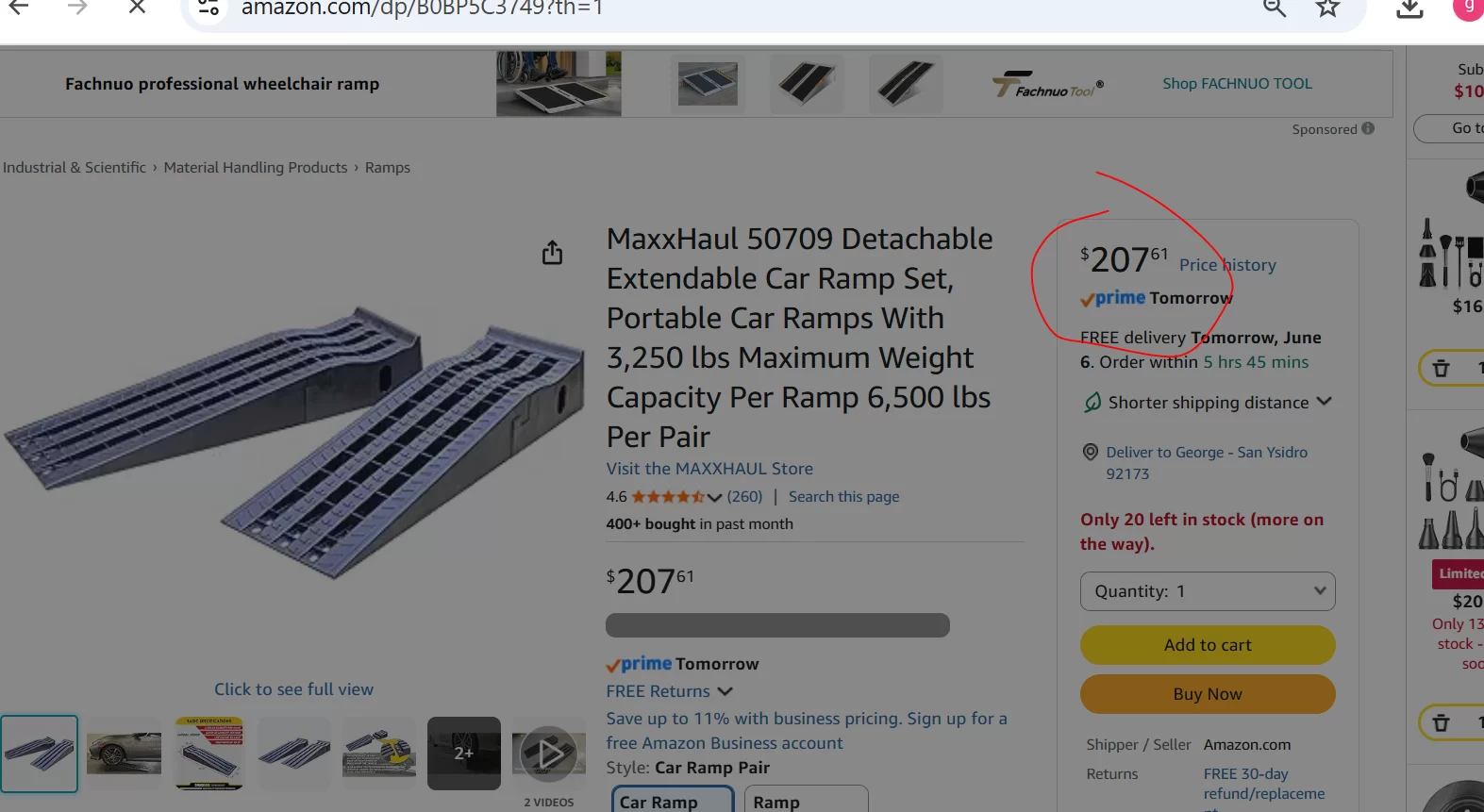

Last month, I contemplated constructing my own ramps and decided to go with these, which I'm very happy with. And the nice thing is that the sloping part can be removed to get access behind the wheels.
MaxxHaul 50709 Detachable Extendable Car Ramp Set
I bought mine from the Bezos Empire, but according to the MaxxHaul website, they are available through other marketplace storefronts.
Those actually raise the car by 6.5" as opposed to my 6". I was just thinking "damnit, I should have found these before I built my own"; then I saw this:)- see below. Yes, when you factor in time, etc; but it was fun to design, lay out in Cad, and build to me:)
They do look really nice though.

Also, I recommend drilling the wood screw holes out approximately 1/32" smaller than the wood screw diameter in order to not split the wood, when putting the screws in. I also drilled a small counterbore so the wood screws heads are beneath the wood surface.

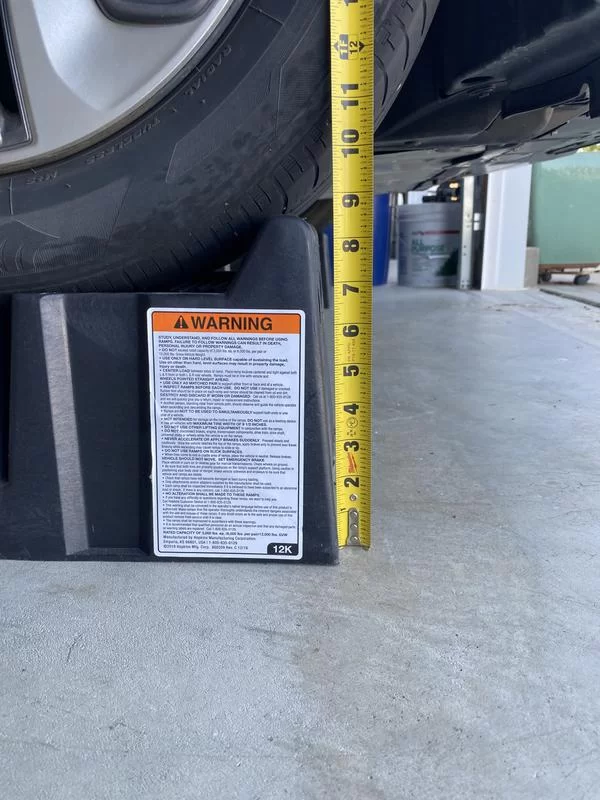

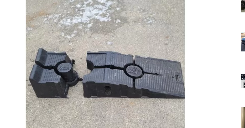

I actually looked at those, and I didnt think that the height of that ramp would clear the 6.5"- 7" vertical clearance of the Clarity on the tire's path to the front of the car. I was thinking that we needed to stay under 7" unless the ramp was longer than 50 inches or so. The Rhino gives 6.5" of lift, but the front stopper piece must me at least 8 inches from the ground, judging from the pictures.
Here is an image from the Rhino Ramos (#11909). It looks like it would not clear the Clarity with around 6.5" - 7" of vertical clearance. Perhaps, you put a board or something before the ramp for it to clear?
OR maybe you use the version that comes apart and you add the high section after the car begins its travel up the ramp.
But once again, it must fit since you have used it for years. I am definitely not doubting you.

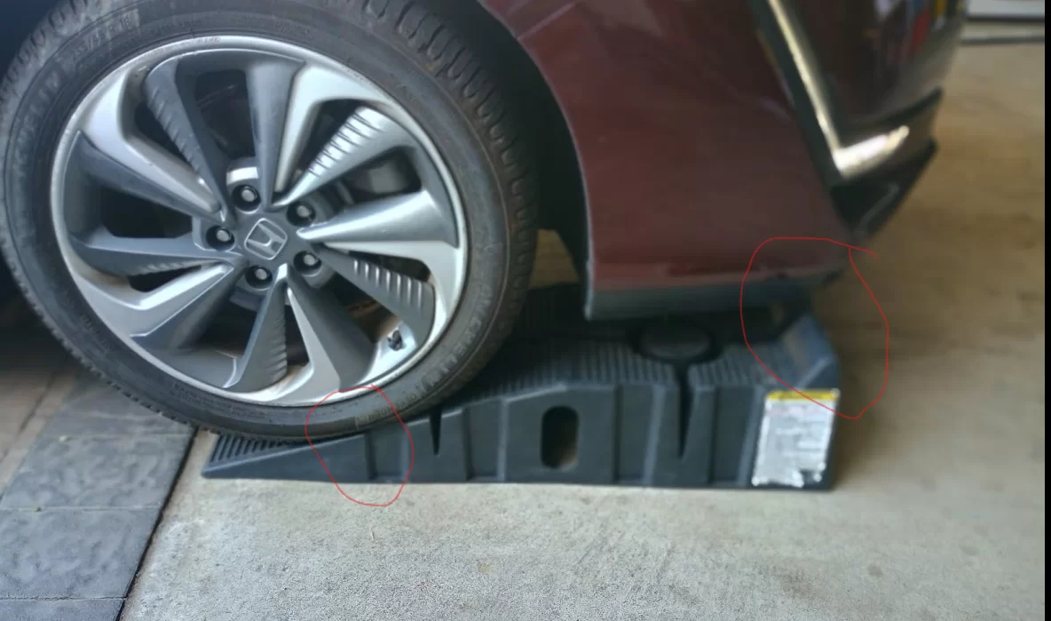

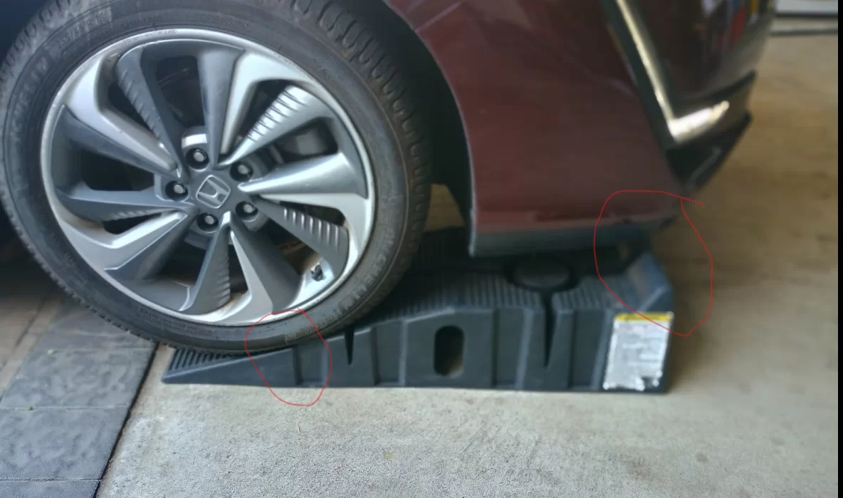

Super Low Priority, but can you let me know the clearance with your Rhino Ramps? I must be bad with math and analyzing dimensions (a terrible characteristic for a Mechanical Engineer:),) because my analysis didnt have those ramps clearing by over an inch of interference. I assume that you are using the Rhino's with the 6.5" of vertica lift.
You are the 2nd person saying that they worked, so I must have bad info. Thanks:)
@Georg99 - I also have a set of Rhino ramps that I have used successfully for years. What your analysis missed was the fact that by the time the bumper is near the the stopper piece, the tire (and therefore the bumper) is already lifted on the ramp section so the bumper clears.
Awesome- things are crystal clear now. Thanks for taking the time to photograph this for me. There isnt a ton of clearance, but it definitely clears and is usable without any mods.
