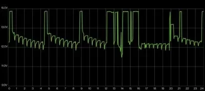

I do use a BM2 and have lots of graphs of the death spiral, and a couple of videos. The EVSE is an Aerovironment EVSE-RS. It's no longer made, and the company's called something else now. The car is 60 feet away from the house. I no longer keep the EVSE plugged in for extended times.
Many other Hyundai owners - not just Konas - have had 12v batteries die in other ways. I suspect there is a flaw in the sequence of operations the Kona performs when it prepares for 12v charging. In that process, it sends signals to the EVSE, which my particular model responds to in a way that causes the death spiral. I've looked at the 12v charging process using the Hyundai EVSE cord at 120v and 240v, and observed other anomalies, but not the death spiral.
I can't rule out an EVSE hardware flaw or design issue, but I think it's more likely a mismatch in the sequence of operations, communication and timing between the Kona and this particular model of EVSE, probably if HV charging ends when the Kona is starting to do 12v charging.
