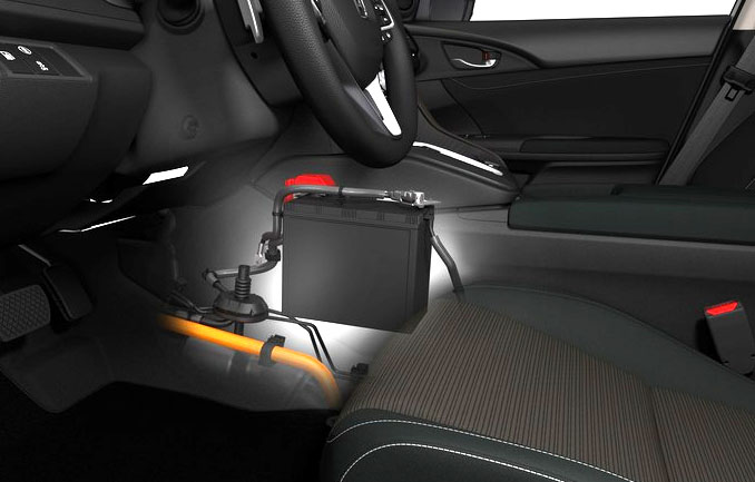

The Clarity's battery is certainly more accessible than that of the 2019 Insight! Where do I drill the holes in the console to attach my jumper cables?
