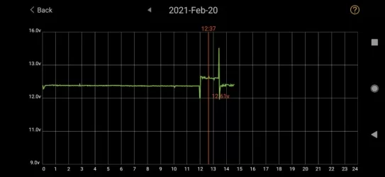

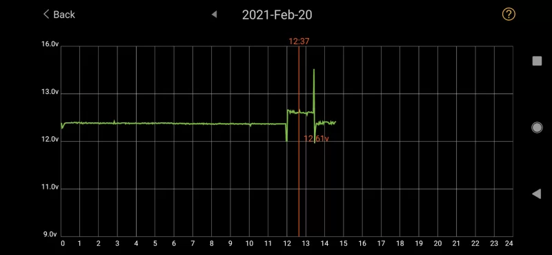

Since my 12v battery failed, and I replaced it, I've been monitoring the voltage frequently, and charging with a Battery Tender Jr whenever necessary. I recently purchased a Battery Monitor from Antigravity Batteries, and I'm now able to monitor it continuously from my smartphone - without having to play with the voltmeter, or keeping the hood up. The results have been generally predictable - I have observed that the battery declines between 0.02 and 0.06v per day with no activity, and that running in EV mode applies 14.56v to the battery. During an active Traction Battery charge, it provides about 13.31v. I did get one surprise, though, that has me concerned.
I took a 76 mile drive in HV mode, and found that it applied only about 12.61v throughout the drive. I repeated the same drive the next day, with the same result. I don't really know if that is abnormal, or not, but that seems way too low to be of much value.
I'm considering asking the Dealer to take another look at the Clarity, especially in regard to the HV charge situation.
In my previous post, I incorrectly called the device I bought from Antigravity Batteries as a "Battery Monitor". It's correct name is "Battery Tracker".
I offered my concern to the Honda Service Rep today, that only about 12.61v is being applied to my 12v battery while driving in HV mode, vs. 14.56v in EV mode. The response I got is that 12.6 to 12.7v is normal for HV mode. That exchange went between the rep and I, then between the rep and their EV "expert", then back to me via the rep, so there was a good opportunity for misunderstanding.
I'm not fully convinced about that, since that voltage seems woefully low to provide any significant charging to the battery. Has anyone else already investigated this on the Clarity, and can confirm what the voltage should be?

I don't use HV mode too much, either, and I probably wouldn't have caught the problem, except that I wanted to burn off a tank of old gas that I bought about the time that Covid-19 hit, and I had forgotten to add Stabilizer. I'm not clear on what the load scenario means, unless it refers to the variations in the demand on the engine and energy recovery or Traction Battery sources during acceleration, coasting, decelerating, stops, etc. On both of my 76 mile jaunts in HV mode, I went through a variety of speeds, inclines and declines, stops, coasting, etc., and both of the resulting charts showed a pretty much constant 12.6v applied to the battery, which was just a bit above the resting voltage of the battery, throughout both runs.
If you can check HV behavior with your Honda Hack gauge, I will really appreciate it. The Hack sounds really intriguing. If it's not too difficult to do, I would like to see if I can add that to my Clarity. The graphs produced by the Battery Tracker device are enormously helpful to me, in that it retains about 30 days of data, but also having a visual instantaneous reference that I could safely check as I'm driving would also be helpful.
I'm almost convinced that the Honda tech misunderstood what I was reporting, especially since it was all third person. I just can't rationalize why they would apply such a low voltage to the battery in one mode vs the other, but the engineering complexity of hybrid operation is beyond my understanding. I do plan to check the HV Charge and Sport modes to see if they behave any differently with respect to charge voltage to the 12v battery.
The Clarity does not have an alternator like a conventional vehicle. It charges the 12V battery using the HV battery as a source of energy.
When you see a voltage like 14.x, that means the battery is being charged. When you see a voltage of 12.x that means the battery is not being charged. It is conceivable to me that there are times when the system knows that the 12V battery is fully charged, so it shuts down the charging process until additional 12V demand requires charging again. This is not surprising to me, but it is a matter of degree. If you NEVER see 14.x volts in HV mode, that is a little strange.

I'm thinking that it probably wasn't a case that it considered the 12v battery as fully charged on either of my HV jaunts. According to the Battery Tracker, the battery voltage at the start of the second run showed it at 12.37v. I don't think that the load scenario was a consideration on either run. Both were in the daytime, with similar outside temps each time, and using the same climate control and other electrical accessories, as when I checked EV mode behavior.
