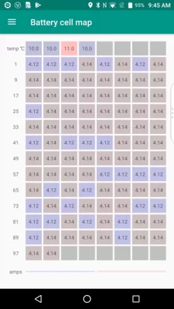

Only way to know, would be to plug into the CAN bus and check the cell voltages are hitting 4.2V at "100%" charge.
The poster I was following is not very technical. Better information is needed from elsewhere.
Yes they called it a “reset” but I think it may be a software update that included a cap on charging.
Our normal "100%" SoC (displayed) has been about 4.165V per cell, pack voltage 408.
I have only charged to 100% once, and when I got home from the charge station did a cell map display with my SoulEVspy. Highest cell group was 4.14, but a bunch were also 4.12. It was a short drive, but it was cold out and the heater was on, so maybe it no longer was at 100%?
