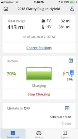

Just got my HV range fixed today then filled up the tank. This is what it is showing on a full tank.

If you it the "i" button on the steering wheel it takes you back to the ev/hv range screen, or whatever screen you had visible before.
Thanks, I never realized that works with the 'Low Fuel' warning too. I know I use it often for other alerts like 'low tire pressure' and 'service required'. I don't know why I didn't think of trying that for the low fuel warning.
