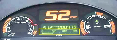

I think the Clarity's Power/Charge Gauge is the best Honda gauge since the original Insight's Fuel Consumption Display (FCD) that revealed the car's instantaneous miles-per-gallon (outlined in yellow below). Later Honda hybrids de-emphasized this important info by making the FCD read-outs much smaller. The Insight's CHRG/ASST Gauge was more like the Clarity's Power/Charge Gauge, but the FCD was the biggest aid for maxing out the MPGs. I shouldn't be using the past tense since I'm still driving my Gen-1 Insight when my wife is hogging her Clarity.
