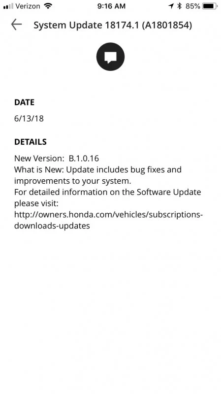

There was a new update to app pushed through last night. My app is working correctly today.
I updated the app. The location date, the location, odometer date, and the odometer didn't update from June 10th. I went to our Clarity, turned it on, selected HondaLink, waited until the satellite icon at the top of the touchscreen stopped blinking. I turned off the car. All data is now current. So nothing changed with the update as far as I can tell.
