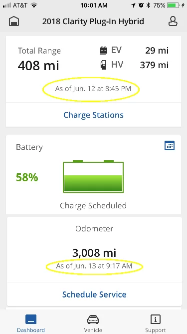

Ok, this started to happen to us now... Range Info and Battery Charging information stopped updating to our HondaLink app since 8:45 PM last night (6/12). Oddly, odometer still updates when we refreshed the screen today (6/13). Honda really needs to fix this issue asap.
