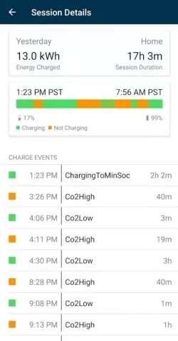

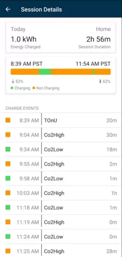

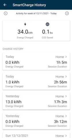

I like the *idea* behind it, but not the execution.
It almost *never* charged my car except early morning, which means its not using the huge amount of solar power available and instead using coal power.
It also left me using far more gas than I would otherwise, because my car was constantly not charged when I went to use it. Basically only charging overnight so my mid-day charging was removed which means my daily commute would use up all the charge and engage the gas engine.
I even ended up having to use a public charger which cost me ~$2 ($10 really since it does it in $10 chunks), for just under an hour so I'd have some charge to pick up my kids later....
I took a few screenshots of how it was "working" for me, so glad that someone found the way to disable it! Sure I "saved" 0.1lb of CO2 during the week I used it, but I burned through 40+ miles of gas as well... sooo yeah doubt I "saved" any o_O
