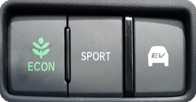

Manual selection of EV driving mode discussion recap:
iluvscuba pointed out that the document "Electric Powertrain System Description - Drive Mode 3752.pdf" states "EV driving mode can be manually selected by the driver." Bobcubsfan appropriately asked, "So, how does one select EV mode?"
The document focuses on explaining the 3 basic driving modes common to all i-MMD hybrids: EV, Hybrid, and Engine, but it never mentions the Clarity by name. Other i-MMD hybrids do allow the driver to select EV Mode. See the 2019 Insight's Mode buttons below:
ECON Mode in the Clarity prioritizes EV driving mode, but the Clarity's ECON Mode can switch to Hybrid driving mode and start the engine in response to higher loads. The ankle-muscle restraint that jdonalds exhibits in ECON Mode achieves the closest thing to a manually-selected EV mode the Clarity offers. Some Clarity drivers on this forum who have the audacity to select SPORT Mode (not me), report it's possible for them to avoid engine-activating exuberance in that mode, too.
There’s no explicit EV mode because, unlike the insight, EV is default.
Honda designed the Clarity PHEV to provide the most efficient plug-in hybrid possible. If Honda's engineers believed an explicit EV Mode would achieve that goal, that mode would be available. It would certainly be a simple matter to include an EV Mode button, but those engineers found it is more efficient to use EV Drive mode in combination with HV Drive mode and Engine Drive mode.
The computer algorithms that combine these modes frustrate some owners who purchased this plug-in hybrid with the expectation that they could choose to drive exclusively in EV Drive mode. I was one of these frustrated owners before I read how the Clarity PHEV was designed to maximize efficiency, not EV travel. I'm glad the Clarity recognizes EV Drive mode as the most efficient way to accomplish most of my driving.
The 2019 Insight is a brilliant 55-mpg hybrid that, like the Clarity PHEV, starts in EV Drive mode if there's sufficient charge in its battery, but not for very far or at significant speeds.
