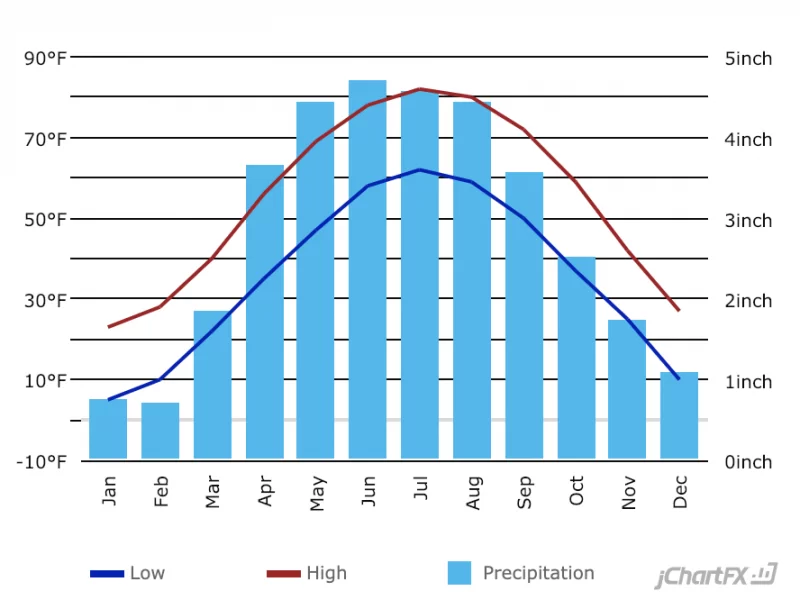

But this really is A Big Deal for many of us. The graph of my climate shows me that for seven months of the year the low temperature is below 40°F. Seeing my EV range increase is just one of many reasons that I'll be happy when the weather moderates.
Seven months of the year? Well, I hope it's not really that bad for you. If you are putting your car in a garage at night, then when you leave in (presumably) the morning, the car should be a lot closer to the average daily temperature than the low daily temperature. If your car really is that cold when you start driving for the day, then you should do as KentuckyKen said: Precondition the car to warm up both the battery pack and the cabin, to preserve as much battery power (and thus range) as possible.
Averages are a wonderful thing. I suspect that my average annual range won't be hugely different from what is specified in the EPA rating. But right now, it's a lot less. Just as I have problems imagining how I will be uncomfortably hot in a few months, right now I am coping with an EV range of about 30 miles and having problems imagining how it will be higher.
I don't have a L2 charger, so when I precondition the net effect is to warm the heater, which is worth doing. But my garage is not heated, and it's cold outside (right now about 0°F), and I am not a person who bought the car so that I could freeze in it. So yeah, I use the heat, a lot of heat, with full knowledge of what it's doing to my EV range.
