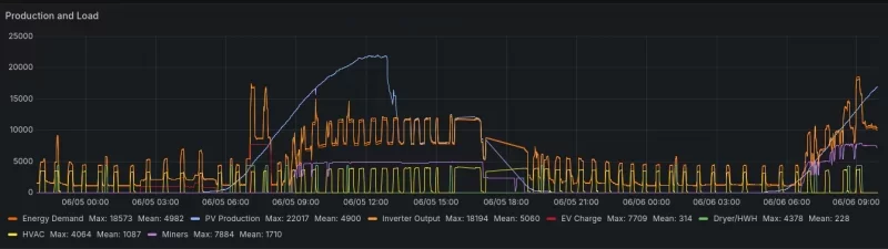

The day I hit 180, I charged a car and ran 3 miners close to wide open all day, peak demand actually hit 99A, a bit more than I wanted, mined about $6 worth of BTC. I would not use an EV battery for storage, too much fiddling & twiddling with semi-custom gear. A 50KWH 48v battery rack can be had for around $12-13k, I'd much rather have standard LifePO4 packs, that don't suffer from thermal runaway.

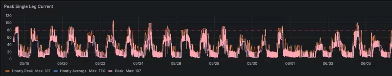

The thing people don't understand about Solar, and power distribution is the first thing you have to take care of is your peak demand. I goofed on the 23rd, I allowed the car charger, crypto-miners, HVAC, HWH all at the same time, the load hit 107A, which is 7A over the inverters rated capacity. Fortunately it was short lived. I also bumped 101 a couple of times in the following days, nothing fell over, it's good to know there is some headroom. I de-rated my sub-panel to 125A just above the inverter output, thankfully I still wasn't close to blowing the main, but my ATS would have cut in if the inverters fell over. I want one more inverter so I can just ignore it.
My 'purdy curves are back for the solar, but you can see 'yestidy when I just ran out of places for the overproduction. Topped off the car (red) with excess battery and anticipation of the sunny day. Crypto (purple) generates a lot of heat, I'm still working on venting the output from the miners outside. Again, demand is going to go WAY up in about a month. The yellow (HVAC) line is going to go flat starting around 13:00 ramping up to 5KW until after 21:00. This means i must have a "full tank" in the batteries to meet overnight usage, and will not be able to "bleed" battery overnight and early AM to fill the EV.
