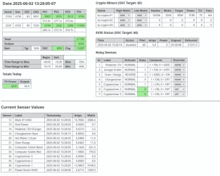

I've had DIY solar for two years. Best ROI is grid tie with microinverters. If you are going with batteries you want an AIO like a Growatt or EG4 with built in MPPT etc. The biggest change I made is trying to charge my car in the daytime when I'm not on battery. I have enough reserve to pretty much do everything else, the GF pretty much runs the TV 24x7. I don't have energy efficient appliances, and I don't care. I have sensors everywhere monitoring my loads, I'm in the middle of revamping the automated scaling for the various EVSE and Crypto devices. Should easily hit 100 SOC on the batteries before 3:30, Crappy day yesterday, I overdid it, batteries bottomed out around 15% last night. The big 4T will flatline at 5KW in July/August, my computer crap pushes my steady state threshold over 1KW.

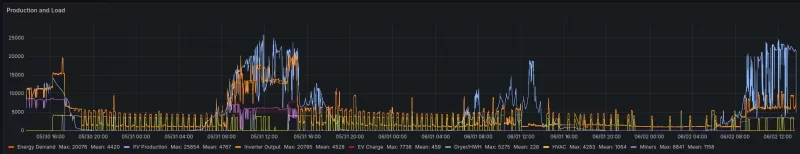

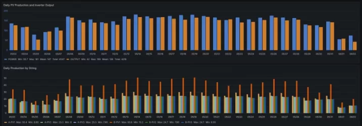

I have 6 strings in panels, totaling around 28KW. A-PV1 is west facing, to catch extra afternoon sun. I broke a personal record of 181KWH a week or so back. I have 60KWH of battery, and 2x12KW output inverters (~ 100A) that run my whole house pretty much all the time. I started running bitcoin miners as a dump load last month or three, my daily usage in July and August can hit well over 100KWH on it's own, so we'll see how that rolls thru the summer.
The day I hit 180, I charged a car and ran 3 miners close to wide open all day, peak demand actually hit 99A, a bit more than I wanted, mined about $6 worth of BTC. I would not use an EV battery for storage, too much fiddling & twiddling with semi-custom gear. A 50KWH 48v battery rack can be had for around $12-13k, I'd much rather have standard LifePO4 packs, that don't suffer from thermal runaway.
