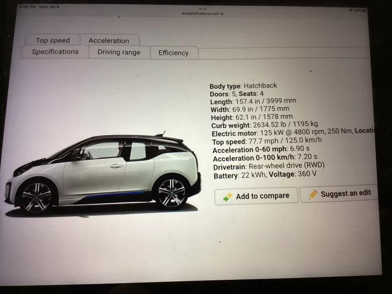

I’m pretty sure there is a video of the SE vs the i3s, but it wasn’t in English I don’t think…
The i3s won but I can only assume that is due to it being ever so slightly lighter and more importantly RWD. It’s difficult to get under 6s in a FWD car, most (like the Mini) limit the launch power.
I believe if they put the motor in the back of the Mini it would greatly improve the launch off the line and beat the i3s. But Minis have always been FWD so…

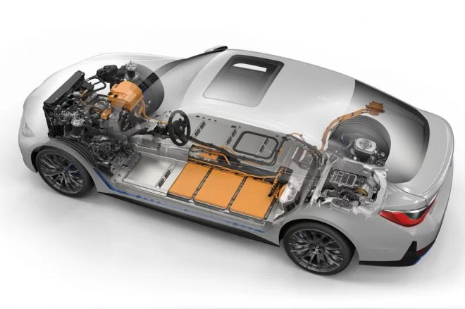

The whole clean-sheet EV debate is interesting. Certainly it seems unfortunate that BMW is using a gas platform for the i4, a premium car released 5 years after the Model 3. I drove one and really don’t have much to say. It was a BMW car. No complaints.
We also owned an i3 (clean sheet design), and Mini SE at the same time. Cool car, but the SE is vastly more comfortable, quiet, and fun to drive. Of the two of them it was, ironically, the better designed vehicle. The i3 had so many compromises including the doors, bicycle tires, junky range extender, and noisy carbon fiber frame. Mini? Just the range and I am totally cool with that. The i3 is gone while the Mini is still with us (and another is on order).
I'm not quite sure what else they could have done for the i4? There is already a structural battery pack but I suppose they forgot the whoopee cushion feature.
With a clean sheet design probably improve packaging and lower the weight. The Lucid for example has incredible interior volume for the exterior size. Better than an ICE car.
Only had 20 minutes with the i4 but it was noticeably tighter inside than a 3 series. Also no frunk, which would be fine if they repurposed that space into the cabin but instead the engine bay has a lot of wasted space.
Not sure what’s contained within the transmission tunnel, but that’s there too for the back passengers to enjoy. The iX (and i3) front center area are quite spacious due to that being gone.

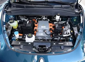

Great Wall Motor's Ora Good Cat has no frunk, so it's doubtful the derivative 2024 SE will have one.
Are there any small EVs that have room for a frunk?
