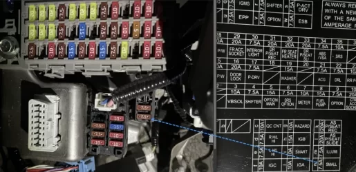

There is something that is referred to as an "Auxiliary Under Dash Fuse Box".
I am not certain where it is exactly, but here is a figure that depicts it:

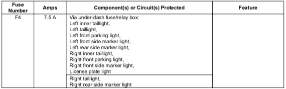

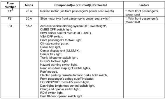

Here is a list of the functions of these fuses:
Note that F4 is the relevant fuse for the taillights, HOWEVER, it looks like a lot of other things would also be out if this fuse were bad, so unfortunately this is not likely to be your problem. I posted this information mostly for general reference.

IT IS UNDER DASHBOARD. If you dont have auto seats adjustment. There is 2 empty slots insted of 2 20amp fuses. And 2 7.5am fuses. Buttom 7.5 fuse was blown. After flooding craked DRL on top of other 10 amp drl/ac fuse under the hood
Thank you all who started this thread and the replies. mine is fixed after replacing the fuse "n" -> "SMALL (7.5A).
