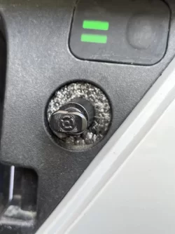

It’s an intriguing theory. You can see the item in question clearly in my photo from an earlier post, right in the centre.
I tried prying it out but it was resisting and I didn’t want to damage it. It certainly does rub (and rotate) against the cover and I can only assume it’s intended to keep it from rattling.
It’s small in diameter but I could see in principle how it could hinder rotation of the bolt if there was debris present.
I did a quick test with some similar plastic but the spring torque present while opening was always strong enough to overcome the rubber stiction. But I'm not having any issues either. A tiny dab of grease might be useful.
