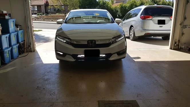

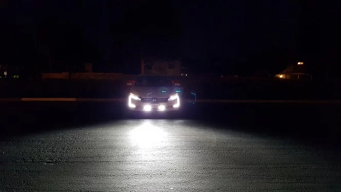

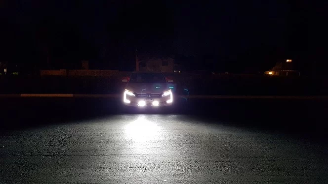

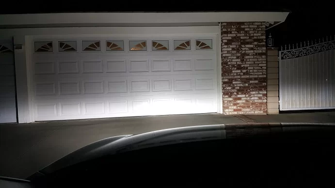

Here is one more picture of fog lights only. They alone can serve as headlights - they are that bright! But check out the glare! :(View attachment 702

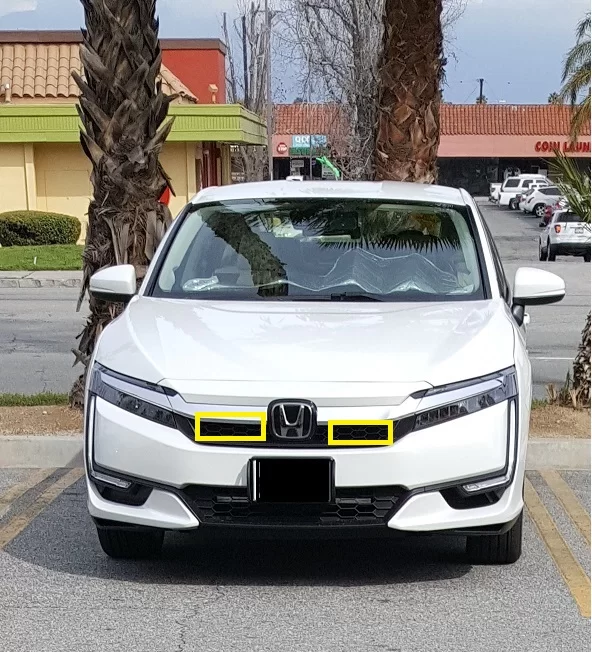

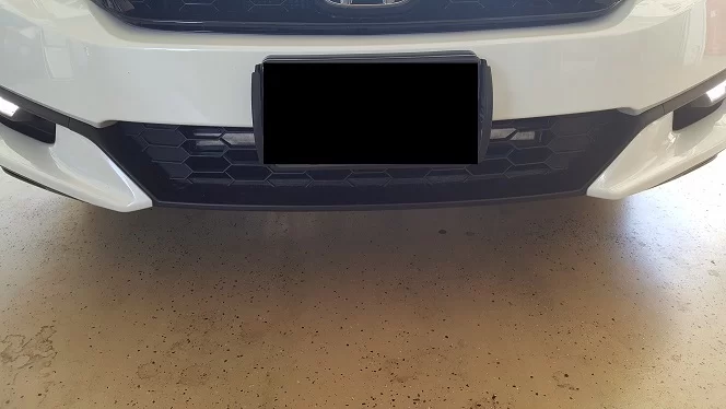

Thanks for the pics PHEVer. I'm thinking of adding some LEDs also but having them trigger with the high beams to avoid adding a switch and wiring to the inside. I'm curious if you have any recommendations about accessing the area you mounted your lights and if you had any pics of yours mounted close up?
Thanks

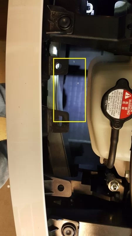

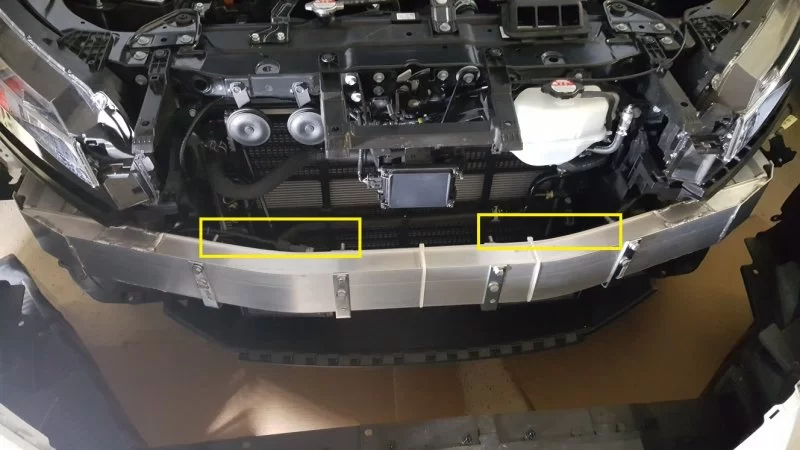

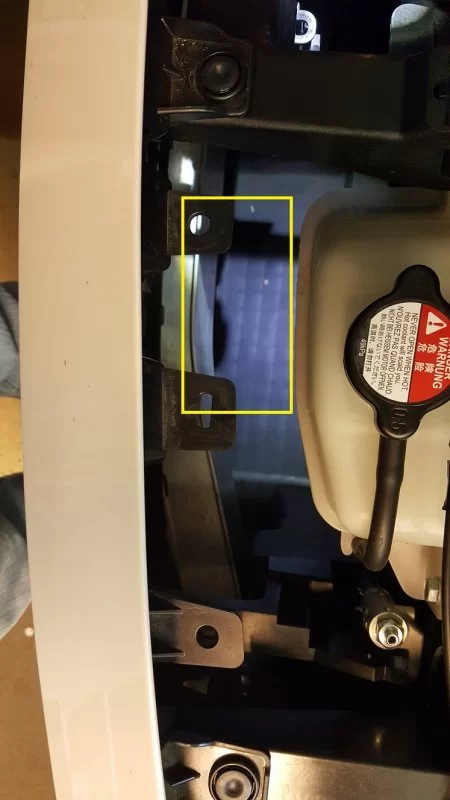

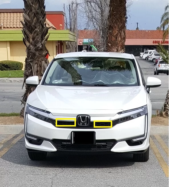

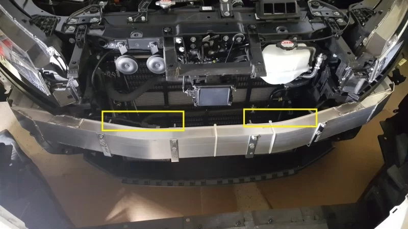

For your purpose, and if you are going with Diode Dynamic Light bars, I would buy 2x 6inchers in driving light pattern (I purchased Wide Angle) and install them shining thru the upper grill

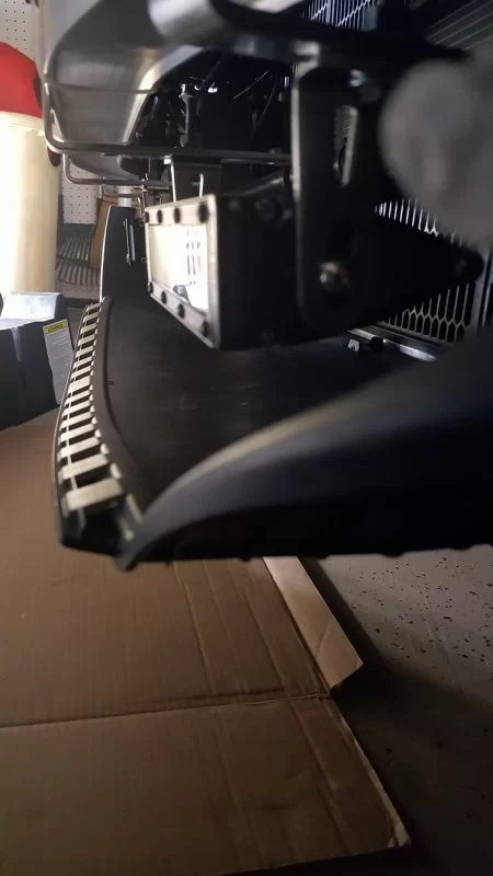

I used heavy duty corner L-brackets. If you do the same, be sure the bumper can still slide in when you re-attach it. So, your corner brackets must be measured accordingly...not too high. You'd want to attach brackets inverse of mine...on the top side.
Had I installed the brackets any lower, the bumper would not be able to slide in.
For the wiring, if you don't want a switch, you'd have to splice into the high beam hot and increase the fuse amperage. Doing it this way will increase your chances of melting wires though. I have no idea what gauge Honda is using for the high beam wiring, but if you are just going to use highs for occassional flashing, it should be ok. Otherwise, I'd use seperate wiring.
There is a video of a Subaru WRX (i think) with the DD 6 inchers as driving lights. They are crazy bright! If you can manage to install them, you will not regret it!...as long as they are aimed well.

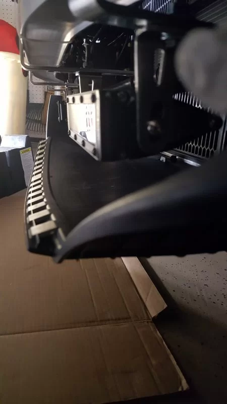

Thanks for the pictures and info. I've wired leds like this before and just used the high beam to run a rely that is bringing power from the battery to the lights. How hard was it to take off the bumper.
Thanks again for the pics.
Do you think that the 2 x 6 inchers might block too much of the airflow? They look like they might obstruct most of the upper grill, and the light bars themselves might get pretty hot as well. There are a lot of things that use the cooling system, including the battery pack, motor, engine, and inverter. I wish there was a way to be certain that blocking off some portion of the grill would not adversely affect anything. Assuming Honda designed it so you can drive it in Phoenix traffic in the summer when it's 110 degrees, maybe you can block off some of the grille and be OK. Or do you think the air would make its way around the lights anyway (if you can set them back from the grille enough) so this might not matter?
I may be wrong, but cars in electric mode don't really need that frontal air circulation; it's for the ICE and the radiator. see Tesla's design. Also the Kia Optima PHEV has a rotating front grill to completely block the airflow to improve aerodynamics. The Volt, and even Prius Hybrid, have minimal frontal air penetration. So, I would not be concerned at all about placement of lights in either upper or lower grill (just not both! I've considered this! Lol!). There is also another air intake on the bottom right of bumper. I would not block that one. Yes, I believe sufficient air does make its way around the lights should the car actually need it.
As far as difficulty level in removing bumper? Well, I am certainly no mechanic and was working alone....I'd say 8 out of 10 the first time. I was only able to use the Accord bumper removal video on Youtube as a guide. But there are some differences with our car (all more difficult differences!). For example, the very top plastic cover also has clips on the anterior side (Civic/Accord do not). Also, there are two clips that connect the front grill to some structure near the headlights (one on either side). When trying to force the bumper straight out (removing all clips along the top and side edges of bumper), the 2 said clips were so stubborn, they would not detach without a fight!
Then, there is re-attaching the bumper. This was diffcult becuase the holes on the underside weren't lining up for me to re-clip. Seriously took over an hour trying to force like 6 or so clips! Next time, I'm just going to widen each stubborn hole with a drill! :D
Knowing what I know now, and if I have to remove the bumper again, I'd say 6 out of 10 difficulty.

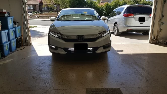

It's the online car review that got me on the headlights. They said they are super bright. Baaahhh. So coming from HIDs since 2000 and then prius LEDs more recently, I was optimistic. Anyways, I purchased aftermarket (Diode Dynamics ss6's wide lens) as this car doesn't have any native fog light option. I installed them behind lower grill. I figured, if I ever need to remove them, there will be no apparent damage/mods to the car. They come on with switch when car is turned on. It's pretty easy to connect them to headlights, if you want to, but I personally didn't want to tamper with/tap into the headlight wiring. Also, they are advertised as being street legal as fog ights due to it's beam pattern (if aimed correctly). Here are some picsView attachment 688 View attachment 689 View attachment 690

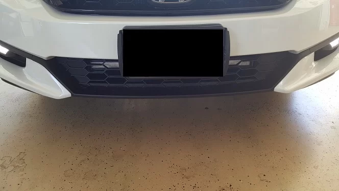

I went to look at some Rigid 6-across horizontal fog lights today. The place I went to is recommending that I install them on the outside of the lower grill on either side of the front license plates. Did you look to do that and if so what made you decide to mount them behind the grill? I can’t see ever taking them off. Like what you did they are going to put them on a separate wire so they will operate at my choice. The upside is that they will stay on even with the high beams on.
I did look to install them on the outside initially. I decided against that for 2 reasons: 1) Potential theft of fog lights, and 2) aesthetics. Mounting lights on the exterior would have had the lights protrude farther out than then bumper as I didn't want to cut through the lower grill. Not sure how deep Rigid is, but if you can find shallow fog lights, installation per the recommendation you got probably would have been best. Here are some Clarity pictures from the Rose Parade...
I did look to install them on the outside initially. I decided against that for 2 reasons: 1) Potential theft of fog lights, and 2) aesthetics. Mounting lights on the exterior would have had the lights protrude farther out than then bumper as I didn't want to cut through the lower grill. Not sure how deep Rigid is, but if you can find shallow fog lights, installation per the recommendation you got probably would have been best. Here are some Clarity pictures from the Rose Parade... View attachment 2725
I ended up installing the rigid fog lights on the inside of the top grill. They make a huge difference and now my wife wants them on her CR-V. I decided I didn’t like the look on the outside of the car (and didn’t want to drill through the bumper). Putting them on the bottom would have required cutting through the plastic grill. The lights run hot and I didn’t want to chance them melting the plastic grill.
